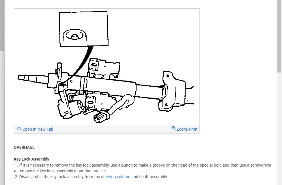

I tried to get it out but there is no button on the top or bottom to push and we drilled it and everything nothing is working what do i do?
Feb 25, 2022 at 9:28 PM
This ignition does not appear to have a button to release it. It appears you have to twist this one out and you do that by using a punch to put a groove in it and a flat head screwdriver to turn it and remove it.

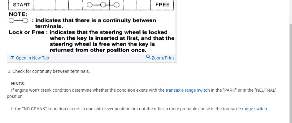

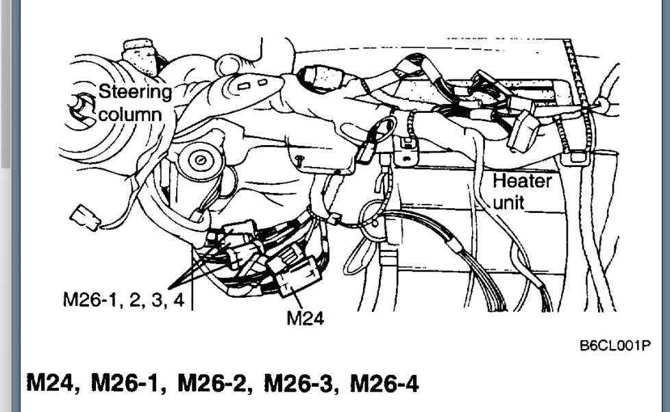

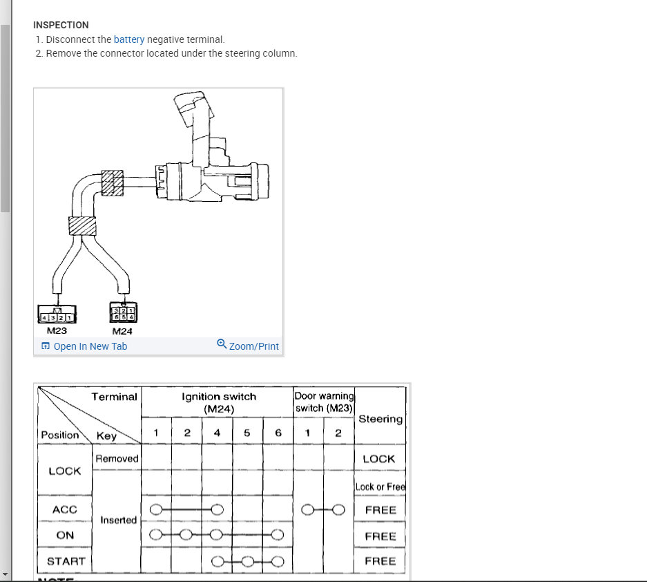

I am attaching the info below from the manual on this that talks about this.
Unfortunately, the manual doesn't have specific instructions that contain a lot of detail, but it does explain what I talked about above.
Please run through this and let us know what you find. Thanks
