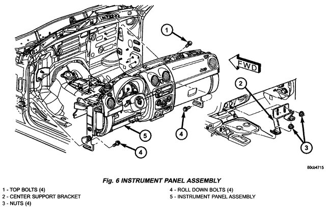

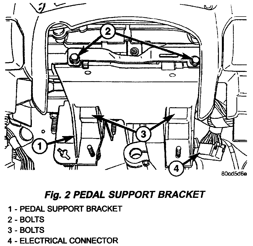

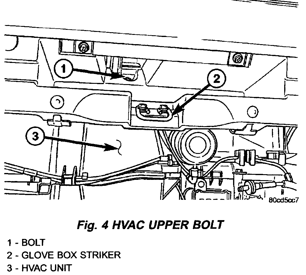

I'm trying to replace my heater core and it's located behind the passenger airbag. I have take the whole day apart but I can only get the dash pulled away a little on the passenger side. I can't find what's hang me up. Help please.

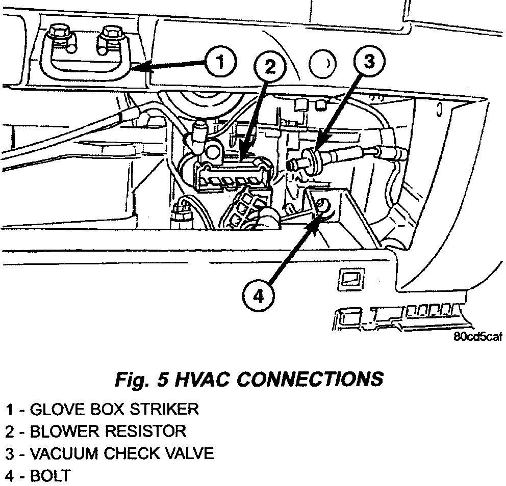

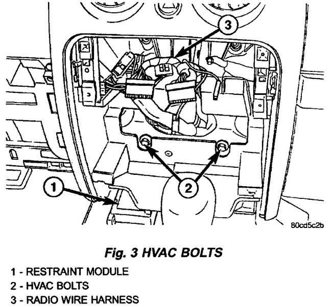

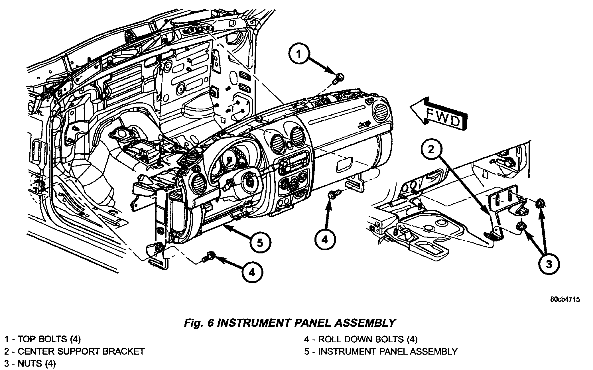

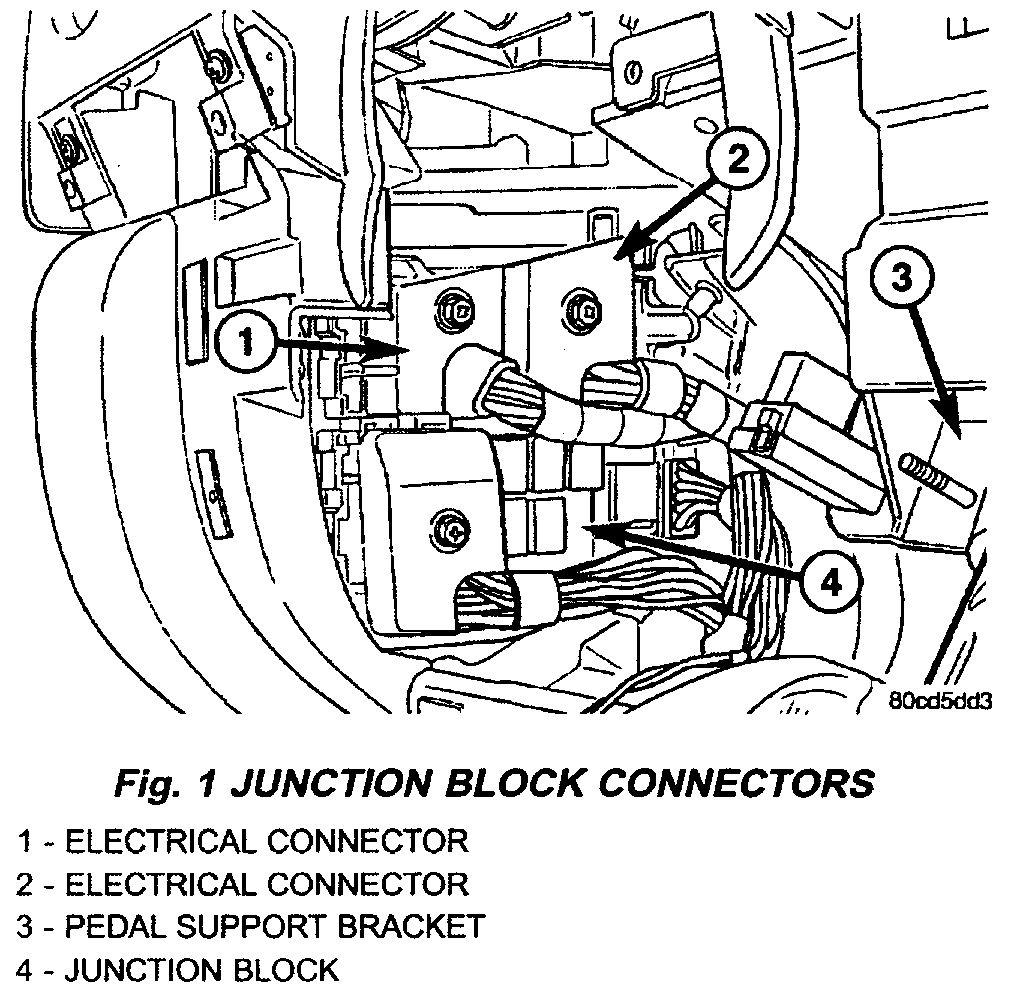

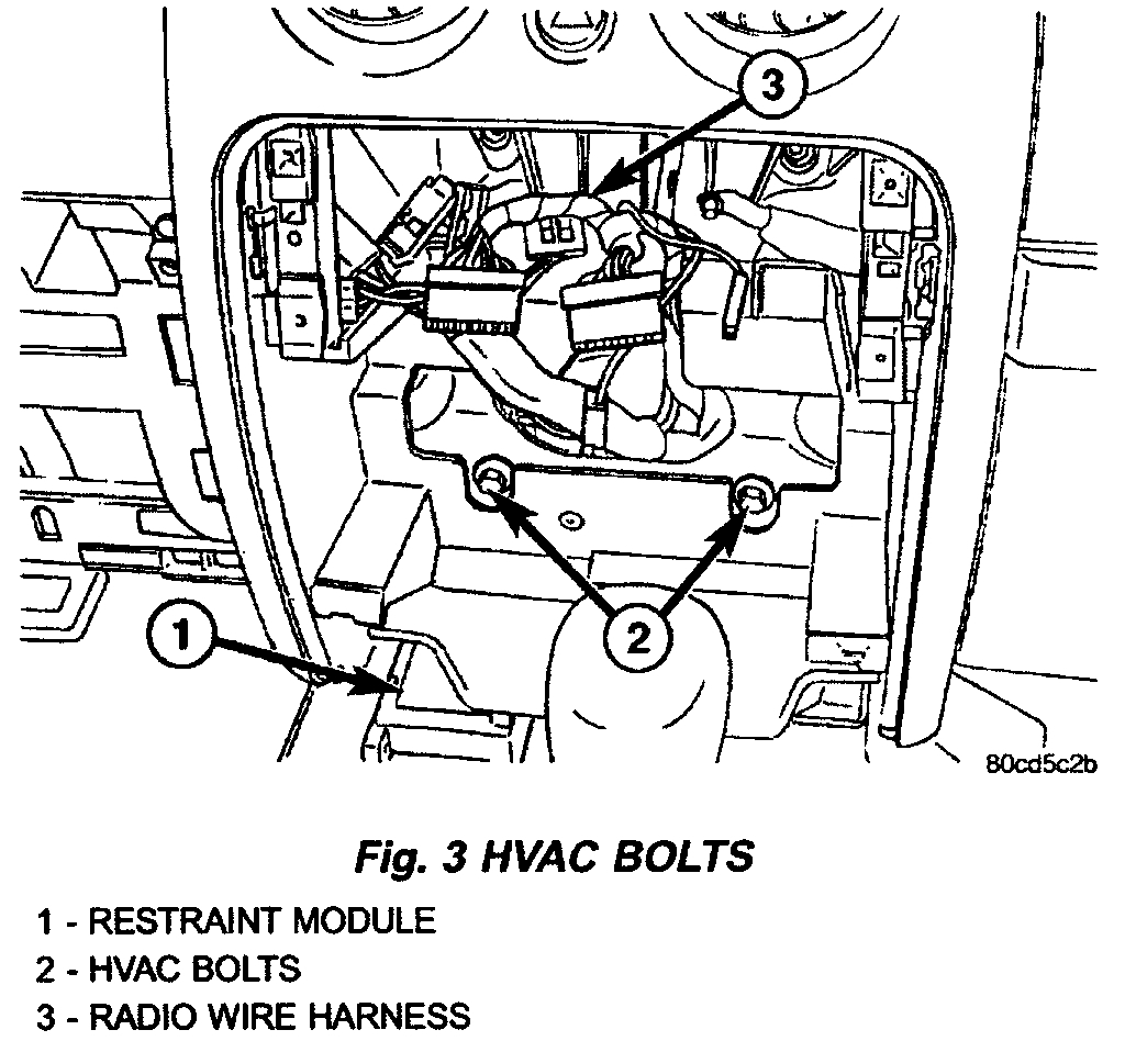

I just looked at the manual at heater core replacement. It said to see HVAC box removal, then it went to instrument panel removal. LOL Here are the directions for removal of the instrument panel assembly. Take a look through it to see if you missed anything. The attached pics correlate with the directions.

Fig. 1
pic 2
(10)Disconnect the green and light blue wire harness bulk connectors at the junction block.
Fig. 2
pic 3
(11)Disconnect the electrical connector at the inner side of the pedal support bracket. (Fig. 2)
(12)Remove the two bolts at the front of the pedal support bracket. (fig. 2)
(13)Remove the two bolts from the bottom side of the pedal support bracket. (Fig. 2)
Fig. 6
pic 4
(14)Remove the two roll down bracket bolts at the left cowl side panel. (fig. 6)

(15)Remove the ground strap bolt and disconnect the restraint module electrical connector. (Fig. 3)
(16)Remove the glove box. See: Glove Compartment > Removal and Replacement > Glove Box
(17)Remove the two HVAC mounting bolts behind the center trim. (Fig. 3)

(19)Remove the HVAC mounting bolt above the glove box striker. (Fig. 4)

(20) Remove the HVAC bolt at the lower outside corner of the glove box opening. (Fig. 5)

Fig. 5
pic 8
(22)Disconnect the blower resistor electrical connector. (Fig. 5)
(23)Remove the two roll down bracket bolts at the right cowl side panel.
(24)Disconnect the vacuum check valve and the vacuum reservoir. (Fig. 5)
(25)Disconnect the blower motor electrical connector.
(26)Remove the four bolts at the top of the instrument panel connecting to the cowl front panel.
(27)Roll the instrument panel rearward and remove the wire harness from routing channel in the rear.
(28)Disconnect the push pin fastener and position aside the radio wire harness. Note the location of the harness for installation.
(29)Remove the instrument panel.
