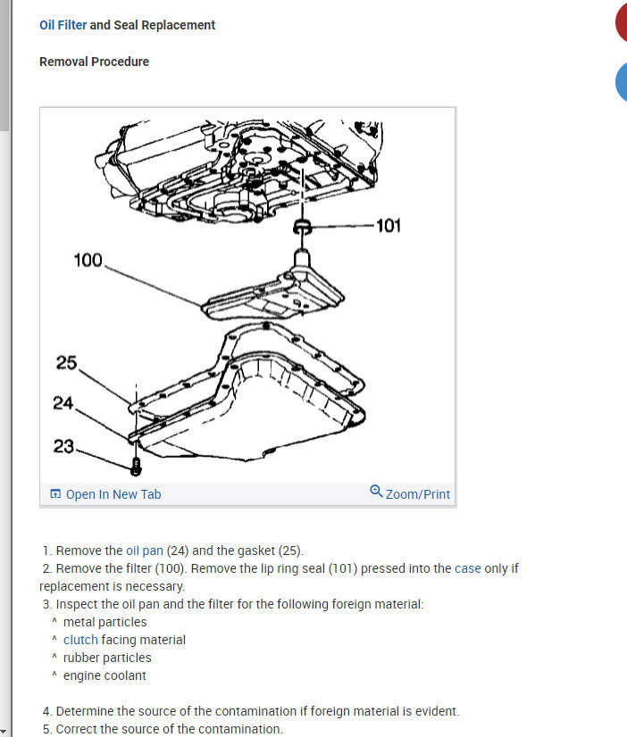

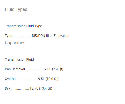

When putting the transmission back in what kind of fluid to use and how many quarts should it take?
Sep 16, 2016 at 5:45 AM
  • CAR REPAIR CONTRIBUTOR

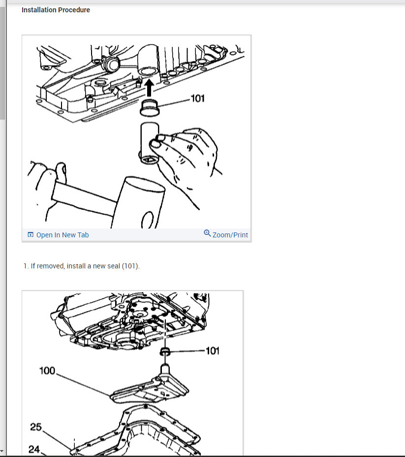

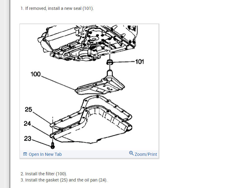

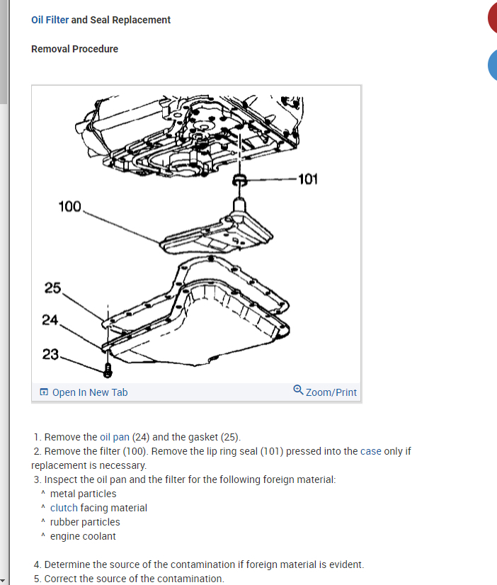

I will attach the specific info below on what fluid and how much to use. However, here is a guide that will help with replacing the fluid and filter:
I am attaching the info below on how to change the filter as well from the manual.
Please run through this material and let us know what questions you have. Thanks
