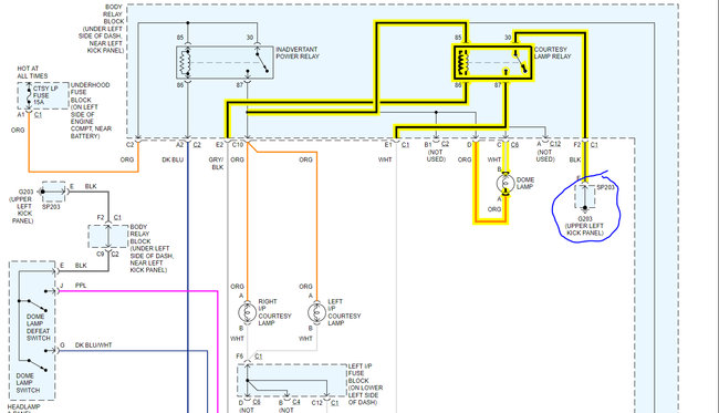

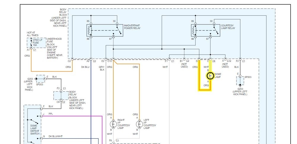

Getting power to interior overhead light, but lights aren't working.
May 31, 2020 at 3:31 AM
Good afternoon,
Can you verify which color wire has power at the overhead dome light?
I attached a diagram for you to view.

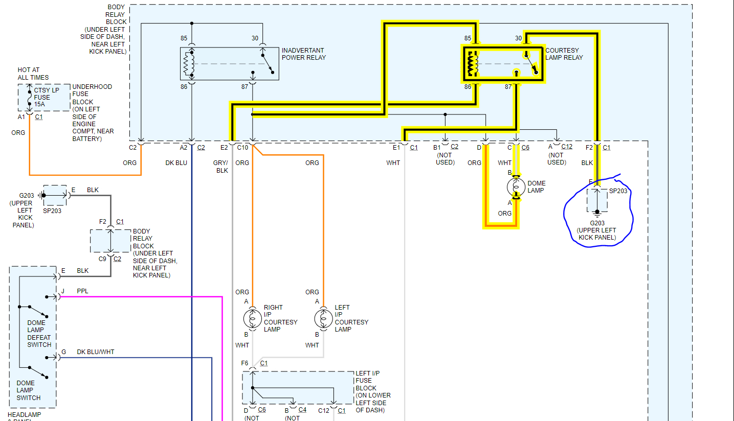

May 31, 2020 at 5:39 AM

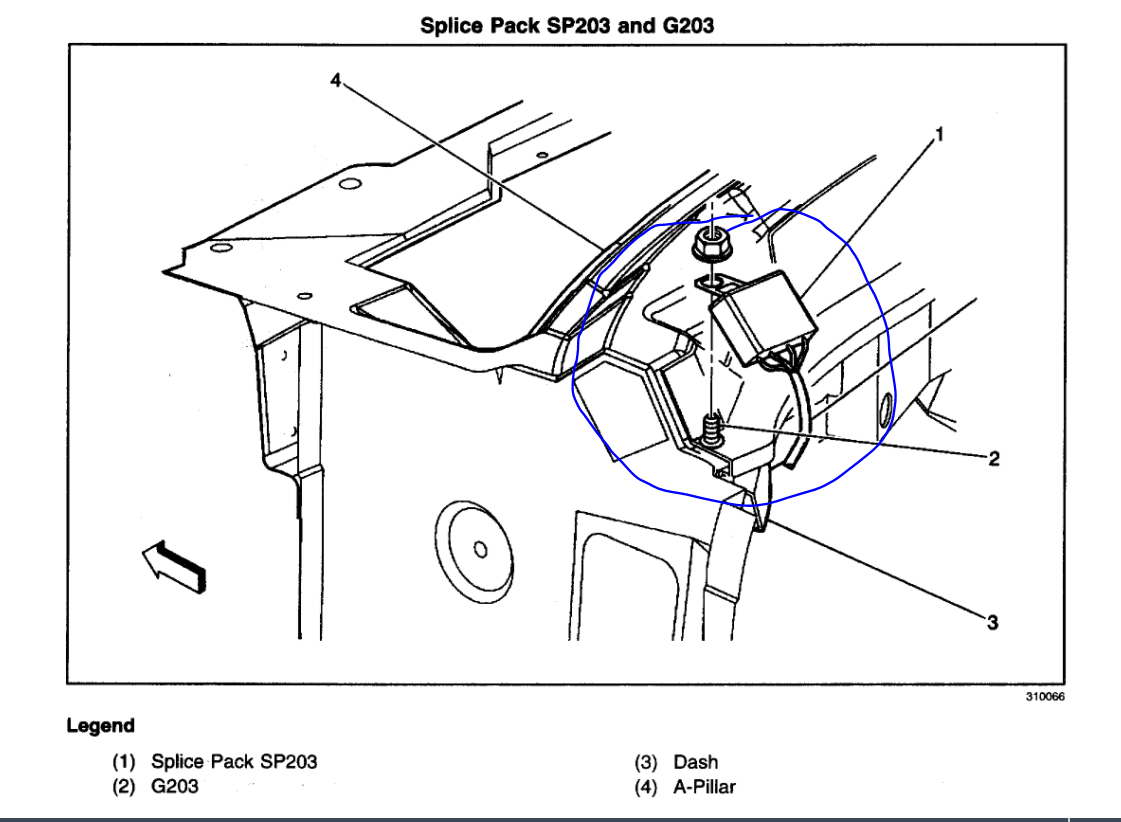

Okay, you need to check the ground for the light. I attached the diagram and circled the ground. I also attached the location of the ground for you. It is G203.
