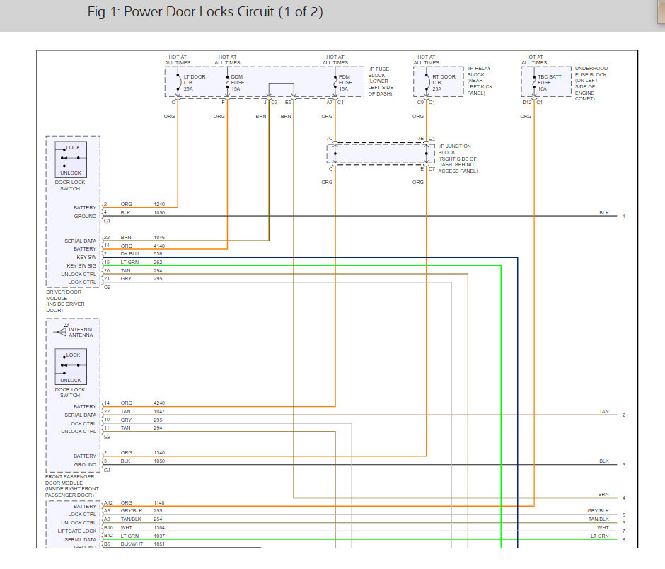

My trunk switch on the exterior handle is getting no power. I've checked the fuses and replaced the switch, the slots that the fuses are in are getting no power. What do I do from here? Buy a whole new fuse box? Trying to find a remedy for this.

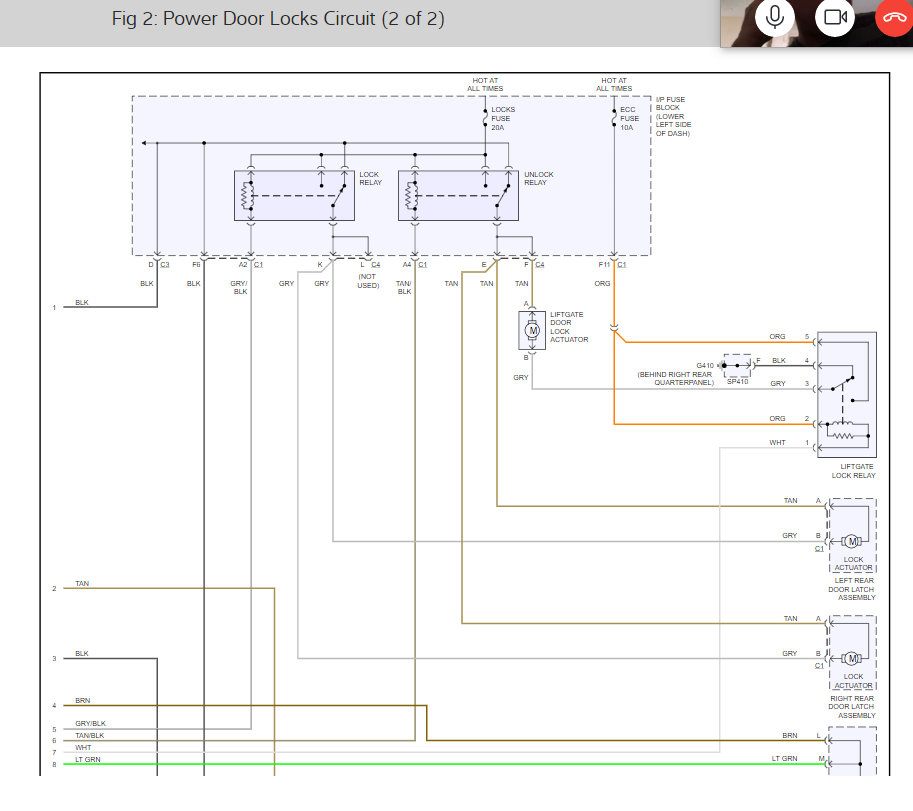

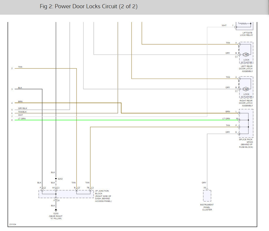

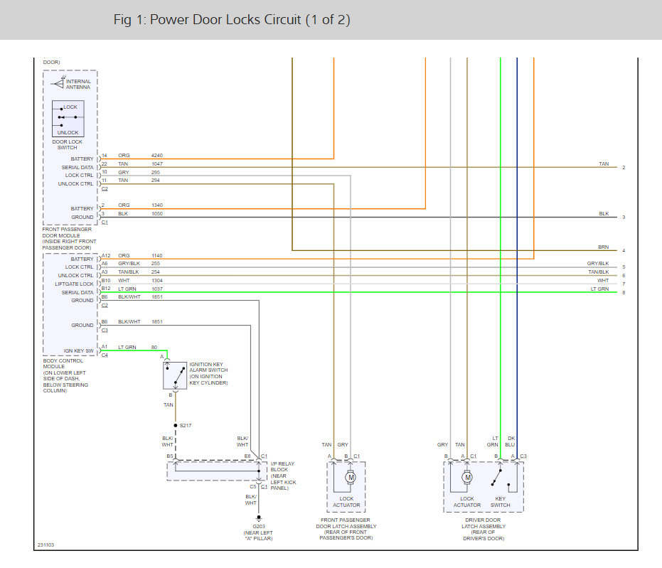

Trunk switch? Lift Gate? Which fuse number is not getting power. Here is the wiring diagrams for the system so you can see how it works. Check out the diagrams (below). Please let us know what you find. We are interested to see what it is.
