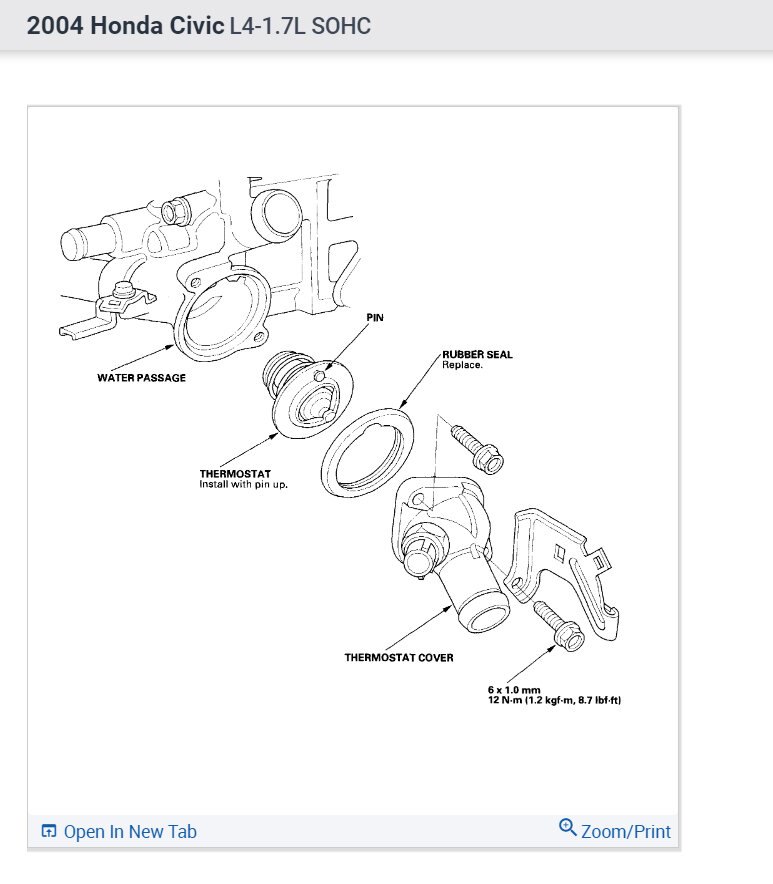

The engine is overheated when you drive it on the highway it is fine but when you get off the highway into town it will get hot fast. It has a brand-new radiator the fans are working the motor only has maybe 20,000 at the most.
May 21, 2023 at 9:01 AM
  • 55,456 POSTS
The first thing I would do is replace the thermostat and check for a blown head gasket. Here are two guides to help us with instructions on how to change the thermostat out in the images below:
and
https://www.2carpros.com/articles/engine-overheating-or-running-hot
