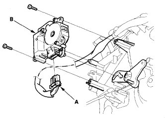

Here are the directions for replacing the actuator if needed. Picture 2 correlates with these directions.
2005 Honda Civic L4-1.7L SOHC
Vehicle » Heating and Air Conditioning » Air Door » Air Door Actuator / Motor » Service and Repair » Air Mix Control Motor
AIR MIX CONTROL MOTOR
Air Mix Control Motor Replacement
Remove the under-dash fuse/relay box.
Disconnect the 7P connector (A) from the air mix control motor (B). Remove the self-tapping screws and the air mix control motor from the heater unit.
Install the motor in the reverse order of removal. Make sure the pin on the motor is properly engaged with the linkage. After installation, make sure the motor runs smoothly.
