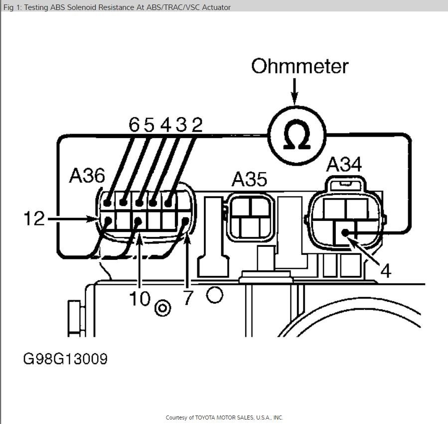

Sorry for the delay in getting back to you. I have delved deeper into this and here are the testing procedures. It is the solenoids and not the sensors that are causing the problem. Go through the testing procedures and see what comes up.

Remove air cleaner and battery clamp cover to gain access to ABS/TRAC/VSC actuator. Disconnect ABS/TRAC/VSC actuator connectors. Check resistance between terminal No. 4 at ABS/TRAC/VSC actuator A34 connector and specified terminals at ABS/TRAC/VSC actuator A36 connector. See ABS SOLENOID RESISTANCE CHECK table. See Fig 1. If resistance is as specified, go to next step. If resistance is not as specified, replace ABS/TRAC/VSC actuator.

(1) Measure resistance between terminal No. 4 at ABS/TRAC/VSC actuator A34 connector and connector A36 terminals listed. See Fig 1.
Fig 1: Testing ABS Solenoid Resistance At ABS/TRAC/VSC Actuator

Disconnect ABS/TRAC/VSC ECU harness connectors. ABS/TRAC/VSC ECU is located behind right kick panel. See Figure. Check for open or short in ABS solenoid circuits between ABS/TRAC/VSC actuator and ABS/TRAC/VSC ECU. See ABS SOLENOID CIRCUIT CHECK table. See Figure and Fig 1 . Repair wiring as necessary. If wiring is okay, clear DTCs. See CLEARING DIAGNOSTIC TROUBLE CODES under DIAGNOSIS & TESTING. Test drive vehicle and retrieve codes. See RETRIEVING DIAGNOSTIC TROUBLE CODES under DIAGNOSIS & TESTING. If code is still present, replace ABS/TRAC/VSC ECU.
