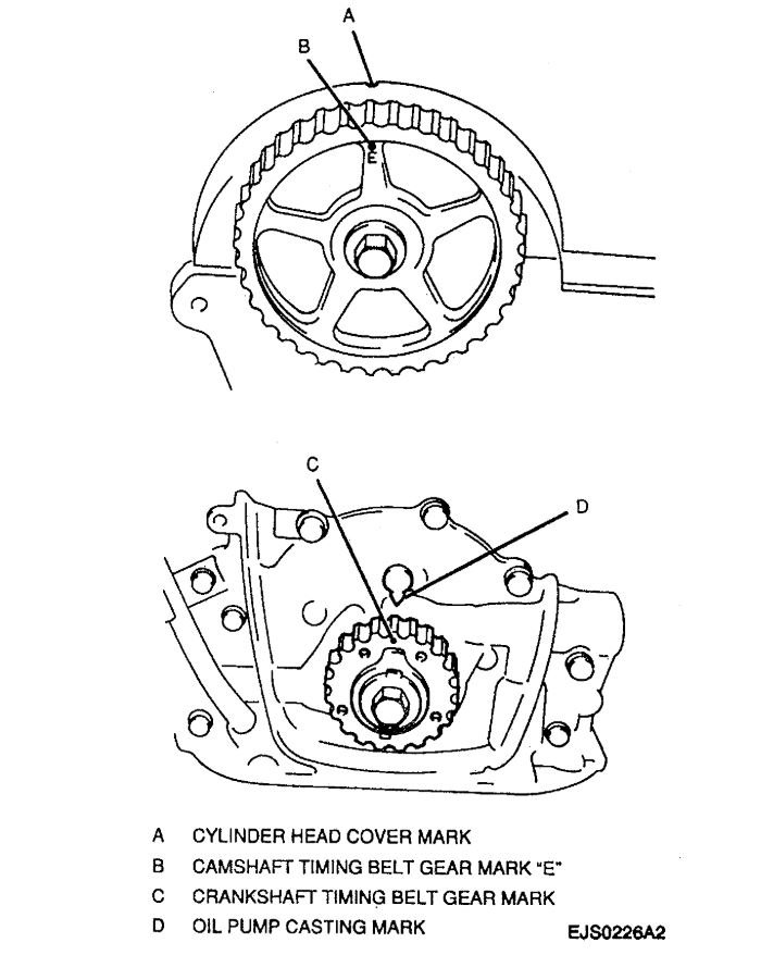

1997 Geo Tracker with 1.6 liter blew a head gasket. Took head in for repair and to be checked. They removed the Cam gear which needs to be put back on. On the gear there is an E and I for aligning the gear on the cam. Everything we've read says E for the dowel and E for the timing mark. When we set it this way, with it at top dead center, 1 and 7 should be adjusted. 7 is on the high side of the cam. It can't be adjusted. What are we doing wrong?

cam mark on 16 valve is 180 out, when aligning timing belt marks as shown dist will point at cyl #4. you have to set the timing belt then turn the crank shaft one full turn and then set the distributor.

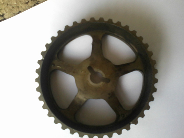

On 96 geo tracker,. 1.6 L 16 valve, single overhead cam, I removed cam pulley, need to re-install to cam. Do I put cam pulley on I or E?

There are actually two slotted keyhole marks on this cam - one has an I next to it, one has an E

the I is for intake and the E is for Exhaust. it is a reference for which stroke the engine is on at that top mark. the compression stroke is the I and overlap is the E.
See the diagram below for timing marks for your engine

They each have a notch, though, both exactly the same and will fit on either way, but in an effort not to ruin the engine... trying to find which notch the pin should go on to the cam pulley to the cam

Here is a pic of the cam pulley...
Jul 7, 2020 at 1:04 PM (Merged)
you have to determine the position of the cam, whether it is on compression or valve over lap. you need someone familiar with camshafts, after you remove the valve cover, to tell you which stroke it is on.

the pin on the cam is on the same spot on every cam so that means that the cam pully will be in the same spot on every one of this motors im asking witch pin hole does it go in it has to be in the same one on every one of this motors i sent pic please look at it
once again, the notch on the gear for the timing marks are not 180 apart. if you use the worng one, you will time the motor wrong and if it is an interference motor, you could bend valves. the position of the cam must be at tdc compression and the mark should be straight up. I mean the notch on the gear by the teeth.

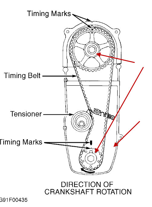

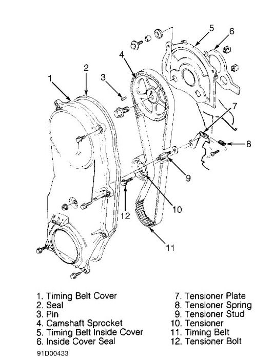

What has to be removed to replace the seal behind the lower timing belt pulley on a 1992 GEO Tracker. Diagram would be very helpful.

this doesn't show everything, but the blet and cover plus there is a pulley at the bottom where the belt goes around in the first pic an dall the stuff with arrows in second pic. then the cam has to be retimed.

That is the Crankshaft and that is the oil pump behind the Crank gear. You'll likely be replacing the whole oil pump and it's no simple job. One mistake with the timing belt will cause you to bend all the valves so I don't suggest to attempt it yourself.
