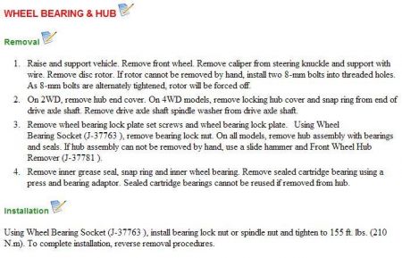

How do I get the front hub off? Is there a special tool I need to buy to get it off? I have broken wheel studs and the hub must come off to replace them.

https://images.2carpros.com/forum/automotive_pictures/261618_Noname_1084.jpg
