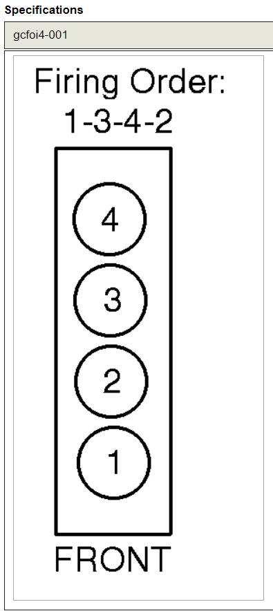

What is the firing order clockwise or counter clockwise..1342?

Clockwise here is a diagram of the firing order (below)
Cheers
