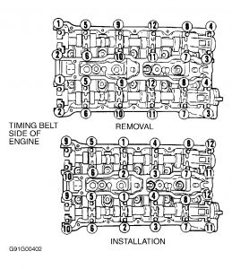

what are the torque specs for the cam caps on a 1992 geo storm gsi with a 1.8 DOHC?

Camshaft bearing cap bolt tightens to 89 INCH Lbs. using sequence below
