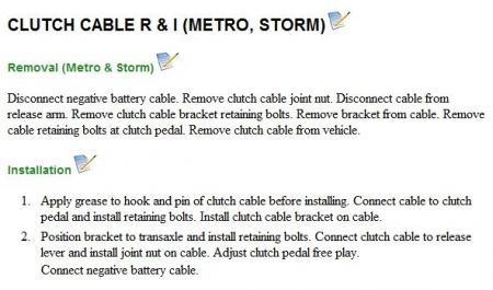

How do you replace a clutch cable on a geo storm

https://images.2carpros.com/forum/automotive_pictures/261618_Noname_2096.jpg
