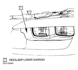

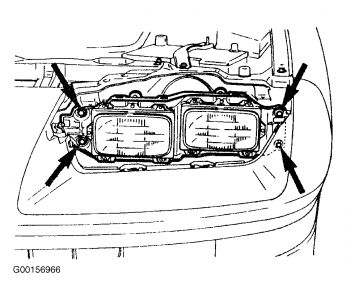

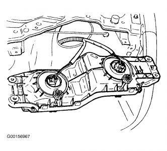

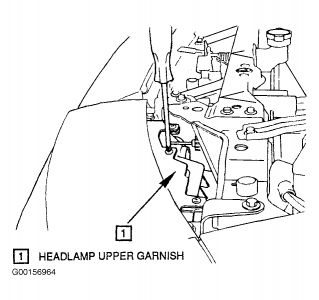

How do I replace the low beam headlight?
Feb 11, 2009 at 9:18 AM
RACEFAN966
  • 5,029 POSTS
Ok first turn on the head lights to get them to come up. Now disconnect the possitive batter cable. Remove the headlamp upper garnish (pic 1 below) Remove the headlamp lower garnish (pic 2 below) Disconnect the electrical connectors to the headlights. remove the 4 attachment screws in pic 3 below. Remove the headlamp unit in pic 4 below. now you should have the light assembly in your hands and now you remove the trim ring and remove the head light and replace it. Now once it is all back together turn off the headlights before reconnecting the battery cable.
