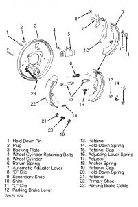

How do I get the rear drums off? I always just tapped with a hammer. not working.

ensure parking brake is not engaged, may have to use adjuster to loosen up the brake shoes from the drum.
https://images.2carpros.com/forum/automotive_pictures/261618_Graphic_521.jpg
