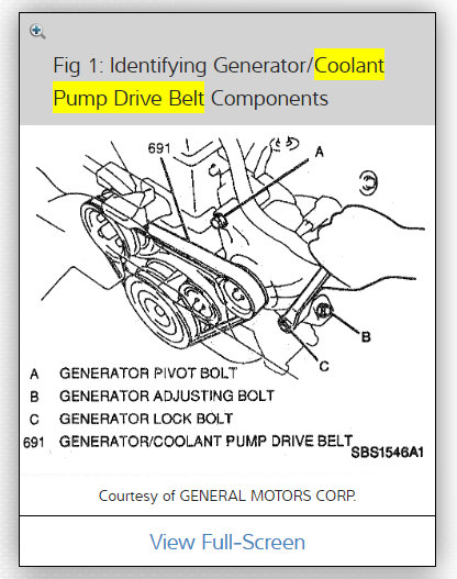

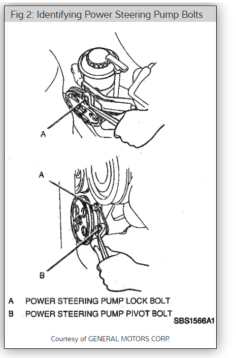

Here is a guide to help see how to change the belt with diagrams below for you car.
Loosen generator adjusting bolt, pivot bolt and lock bolt and Remove generator/coolant pump drive belt. Check out the diagrams (Below). Please let us know if you need anything else to get the problem fixed.
