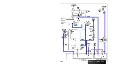

Ok, I disconnected the fan switch on the thermostat housing and the fan started running so is there something more I should check than the fan switch such as a fuse or relay? I took it for a drive and it never got above normal operating temperature so I think the fan is just fine. Any thoughts would be helpful because if I can help it I don't want to just be throwing parts at it.

Test the fan no. 1 relay see below diagram then comback when it continues-unable to read it give me your email addy.
https://images.2carpros.com/forum/automotive_pictures/12900_relay_21.jpg
Jan 11, 2009 at 9:01 AM
