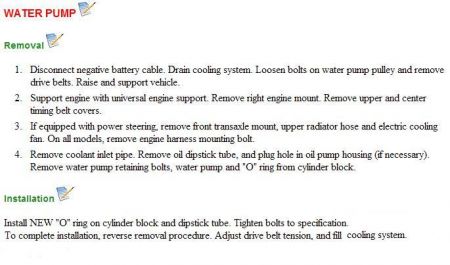

How do I replace the water pump?
Aug 19, 2009 at 1:13 PM
BLUELIGHTNIN6
  • 16,542 POSTS
https://images.2carpros.com/forum/automotive_pictures/261618_Noname_851.jpg
