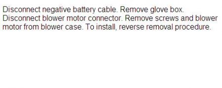

Hello Guys,
I need to replace the blower motor on my sons 1995 Geo Prizm. The New England winters get cold and I can see making him freeze haha. When I turn the fan on I can hear the motor making a loud winding noise with no real air pressure coming through the vents at all. This is why I am assuming that this is the problem. I would like to get the part and replace but I dont know if this is located in the dash, in back of the glove box or if it is under the hood? Any help you can give me would be greatly appreciated.
Thanks,
Paul from Meriden CT

https://images.2carpros.com/forum/automotive_pictures/170934_95_geo_1.jpg
Welcome, the database showed the above info, sorry didn't see a picture.
