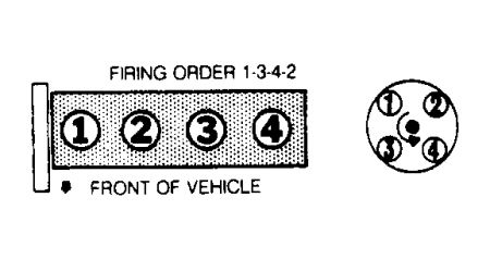

during wire replacement wires mixed up need correct
order
