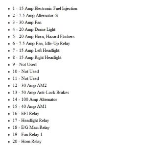

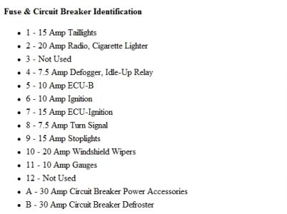

yes where is my fuse for my fuel pump located at on my 1994 geo prizm car. i can not find it to see if it is blowen. i just changed my fuel pump my car will start but not stay running

https://images.2carpros.com/forum/automotive_pictures/261618_Noname_2239.jpg
https://images.2carpros.com/forum/automotive_pictures/261618_Noname2_732.jpg
