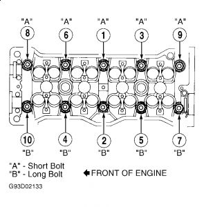

what is the sequence and pressure of the bolts

The 1.6 liter engine, start in center and work your way out to ends. Start with 20ftlb, and final torque is 44ftlb. You MUST put head bolts in same place they came from, or (Better yet) use new head bolts. Dip threads in oil and put some oil under bolt head.
