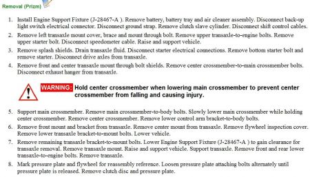

How hard it is to replace a clutch? It was replaced by a family member 8 years ago, but he is not available to replace it again for another 2 months. However, I need my car back ASAP.

if you have little or no mechanical experience than this is not a job you will want to take on..i have posted the replacement steps below for you to look over..
https://images.2carpros.com/forum/automotive_pictures/261618_Noname_2781.jpg
https://images.2carpros.com/forum/automotive_pictures/261618_Noname2_903.jpg

If you replace the clutch, replace the rear main seal while you have it apart, unless it was replaced last time.
