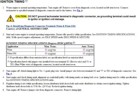

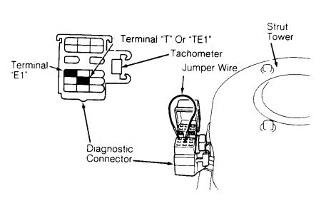

I need to know how to time this car? I need to know how to make a jumper for the fuse box and what part of the fuse box do you jump.
Aug 29, 2008 at 11:10 AM
MHPAUTOS
  • 31,937 POSTS
Hi there, Do the ignition timing as per instructions, as for the jumper, you can use a small split pin or a small length of wire. Mark (mhpautos)
