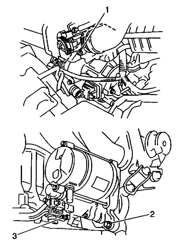

What is procedure to starter installation and what side of engine is starter on
Jan 14, 2008 at 7:45 AM
MMPRINCE4000
  • 8,548 POSTS
Starter is on the firewall side. Best access is to remove passenger wheel and lower stone covers. Remove from underneath with car on jack stands.
Remove the negative cable! before you start.
Starter has two electrical connections, large from battery and small for solenoid.
Remove two starter bolts (careful it's heavy).
Mount new starter, insert bolts tighten to torque specs, usually 25lb-ft. Reconnect electrical, connect negative battery cable.

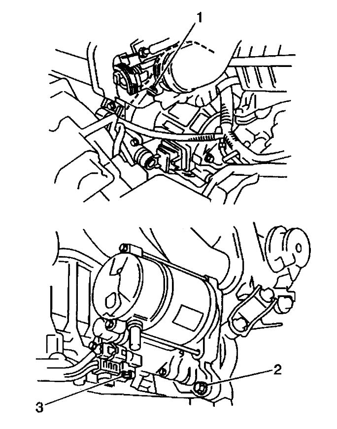

See the diagrams below for a little visual help

How do i get the starter out do I have to take off the fuel injection deal over the top of the engine.
Jan 14, 2019 at 9:25 AM (Merged)
MMPRINCE4000
  • 8,548 POSTS
raise car put on stands. Disconnect neg. battery cable.
Remove passengers side wheel and stone guards. Disconnect starter electrical connections, remove starter bolts, one faces drivers side, one passengers side, remove starter.
