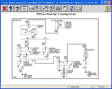

I have a good battery and new starter on the car, when you turn the ignition you get a clunk but starter will not spin. with the old starter i could bump it with a bar and it would crank. now with new starter getting same results as old starter. any suggestions.

https://images.2carpros.com/forum/automotive_pictures/416332_1990_geo_prism_starter_wire_diagram_1.jpg
First of all thank you very much for your donation.Do you have a test light or multimeter so we can trace power?

yes I have a tester and starting to test this morning.

I would make sure that your battery cable's are clean and tight.That your battery has more then 12 volt's in it then i would check and see that the black and red wire and the black wire to the starter both have battery voltage to the starter when the key is in the start position.If it does then you have a bad starter bad battery or a locked up engine.
