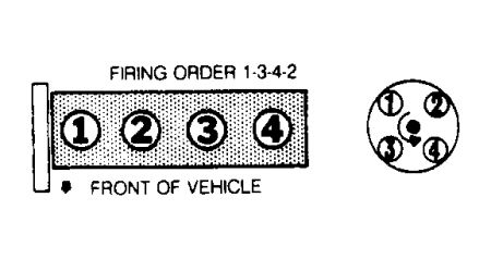

What is the timing on a 1989 Geo Prizm with a 1.6 motor and vin code # is 6. Thanks.

Timig is 6BDTC at 650 RPM
