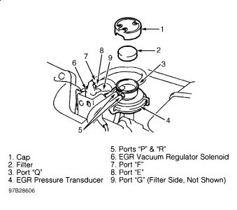

ECM most likely triggers with ground, its easier on it.This system has a pressure transducer (See Pic).
https://images.2carpros.com/forum/automotive_pictures/1639_geo_1.jpg
Has this item been checked? these burn out alot, they are common on Toyotas. Has 3 vacuum lines on top and 1 to the EGR pipe(exhaust) on the bottom.

yeah the pressure transducer has also been replaced with a dealer part. i drove it again with a voltmeter on it. i hooked it up to one wire and the battery ground,drove it,no change. then hooked it up to the other wire,also no change. hopefully that is the right way. it read on both wires battery voltage the entire time,14.01. at least the alternator works,haha. another thing is i got a hold of a gm tech 2 scanner and i can active command the solenoid on and the engine dies.
