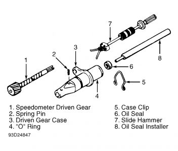

Speedometer has failed suddenly along with odometer. Removed transmission cable. It appears OK. Never experienced symptoms of a squeaky cable or erratic speed readings before sudddn failure.
does this transmission have an electronic sensor?
If a gear has failed could this be in the tranny AND/OR the instrument cluster? What steps must I take to make repair?? Is there a part in the tranny that the cable inserts into that may have failed? If so how can I remove and replace this part???

OVERHAUL - 5-SPEED -1996 Geo Metro Page 1 of 1 SPEEDOMETER DRIVEN GEAR ASSEMBLY Removal Pull up speedometer cable boot. Remove speedometer case clip and disconnect speedometer cable from case. Remove bolt and speedometer driven gear case assembly. Disassembly Drive out spring pin and remove speedometer driven gear. See Fig. 2 . Hold driven gear case with camshaft sprocket holder and remove oil seal. Remove "O" ring. Reassembly Install oil seal with spring side down. Install speedometer driven gear into case and drive in spring pin. Check driven gear for smooth rotation. Install "O" ring. Installation Apply grease to "O" ring and install case assembly to transaxle. Install bolt and torque to 53 INCH lbs. (6 N.m). Connect cable and install clip and boot. Fig. 2: Exploded View Of Speedometer Driven Gear Assembly Courtesy of GENERAL MOTORS CORP. 8/28/2008
