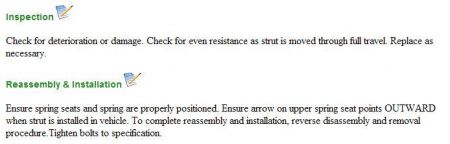

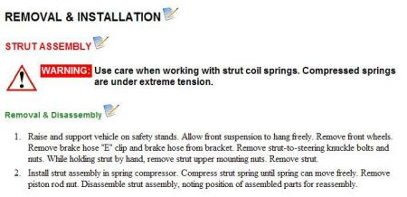

How difficult is it to change the front struts on this metro? Do I need any special tools?
