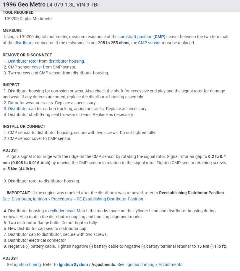

If my car has been setting for a while during rain or high humidity my car will not catch. It will chug and chug but not actually start. A few hours or so later, after the rain has subsided the car will start. It's gotten to the point where I almost have to check the weather forecast before parting so I won't get stranded. Thx.
Jan 1, 2008 at 10:52 PM
SQM
  • 6,383 POSTS

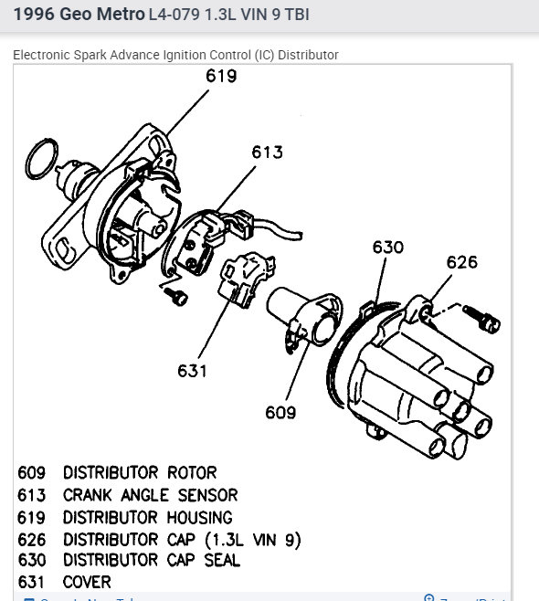

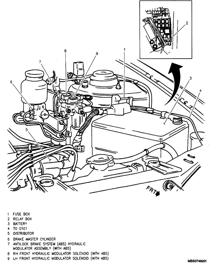

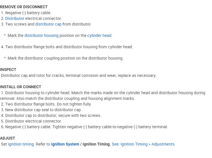

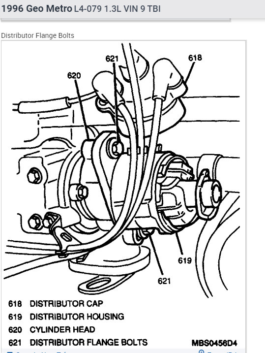

It sounds like moisture is going into the distributor cap. Probably due to a bad seal or a crack.
This is preventing the engine from getting spark and not starting.
As it dries up the spark is produced, and engine starts.
Inspect the distributor cap, there is a good chance of having corrosion inside the cap due to moisture.
Any time the cap gets replaced; it is recommended to replace the rotor as well.
