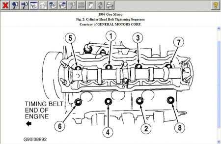

Engine Mechanical problem
1994 Geo Metro Manual 100000 miles
need sequence
Jan 23, 2010 at 8:52 PM
Experienced Mechanic
75,988 POSTS
Tighten it 54ft lbs
