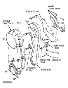

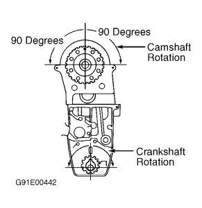

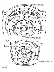

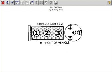

kI UNDERSTAND THE TOP DEAD CENTER FOR THE TIMEING MARKS ON THE CAM AND THE CRANK SHAFT GEARS BUT IT'S A 1.0 3CYL WHATS THE FIRING ORDER AND WHICH IS THE #1 PLUG? I'll have to take the timing belt all the way off to aligin that up right?

This is your timing marks once you set it up it should be with the marks on remove and install the belt need manual CHECK IT @ http://www.2carpros.com/kpages/auto_repair_manuals.htm

You need to stay in one post this is your 3rd one with the same problem Put the engine no. 1 piston on its compression stroke-align markings and make sure the rotor is pointing at no.1 cap tower if not your 180deg off
