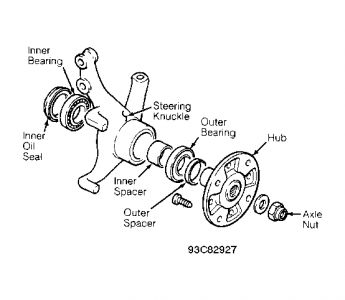

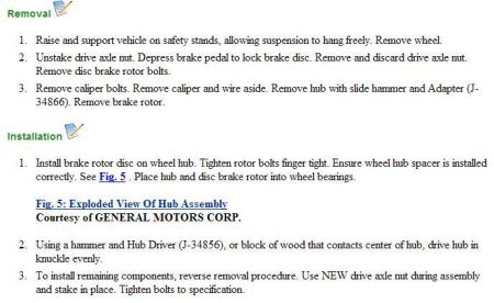

How do I remove the brake rotors on this beast? They are behind the wheel hub. I removed the axle nut but the hub will not come off easy. Do I need a wheel hub puller?
