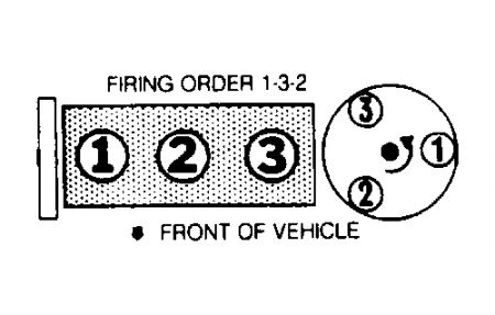

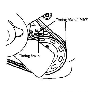

YOU told me to align my timing marks top dead center on my geo but i dont know the fireing order for it. It's a 1.0 3cyl can you give me the order and which plug is #1 plug?

u do not need the firing order to set the timing
check the diagram

https://images.2carpros.com/forum/automotive_pictures/99387_Graphic1_53.jpg
https://images.2carpros.com/forum/automotive_pictures/99387_Graphic2_31.jpg
