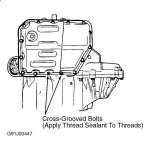

I drained tranny fluid and replaced filter. Need to put the pan back on with new gasket but did not take note where the 2 recessed crossed bolts were due to mega grease/gunk on all bolt heads when removing. Chilton's book says to put loctite on those two bolts but I don't know what holes they belong in. I've tried to research online but am not finding any photos or diagrams that show me.
Can anyone help?

see if this helps you..
https://images.2carpros.com/forum/automotive_pictures/261618_Graphic_138.jpg

This diagram is exactly what I was hoping to find when I searched the internet. Thank you so kindly for posting it.
