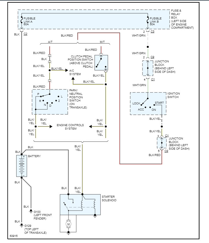

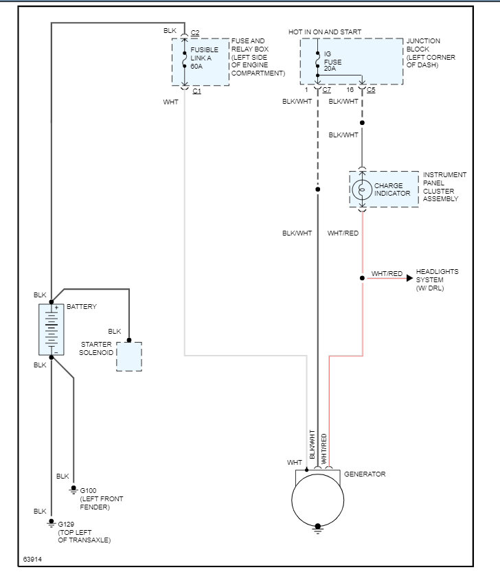

I changed engine and cant get starter and alternator wires in the right places, need help
Feb 24, 2010 at 8:20 PM
BLUELIGHTNIN6
✓ASE Certified Mechanic
16,542 POSTS
Here is the wiring diagrams for the starter and alternator please let me know if you need anything else. Check out the images (Below). Please let us know what happens.
