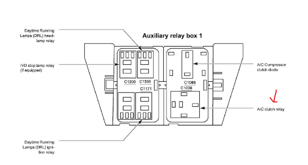

So, I have the vehicle listed above XLT 5.4L Triton 16V 8 cylinder.
The Troubleshooting Issues:
1 Every time the truck sits for too long it needs a jump, and the battery was replaced last year brand new

We only handle one problem per thread. Please start new questions for the tune up and transmission fluid issues. The battery draw sounds like the A/C compressor clutch relay is stuck on. so, I would remove it to see if the drain goes away, here is the location of the relay and a guide to help you go over the easy fixes for the is as well.
https://www.2carpros.com/articles/car-battery-dead-overnight
