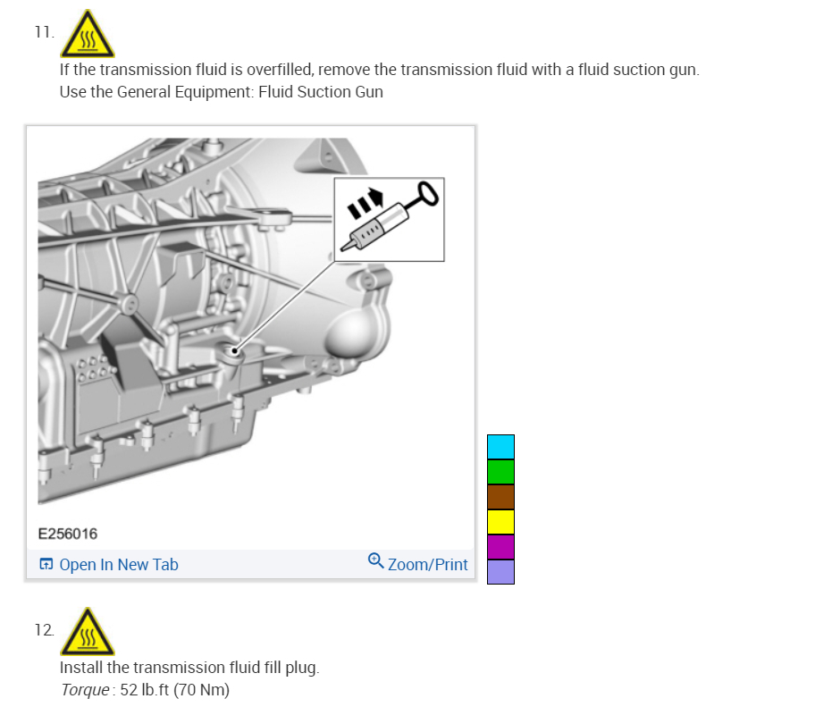

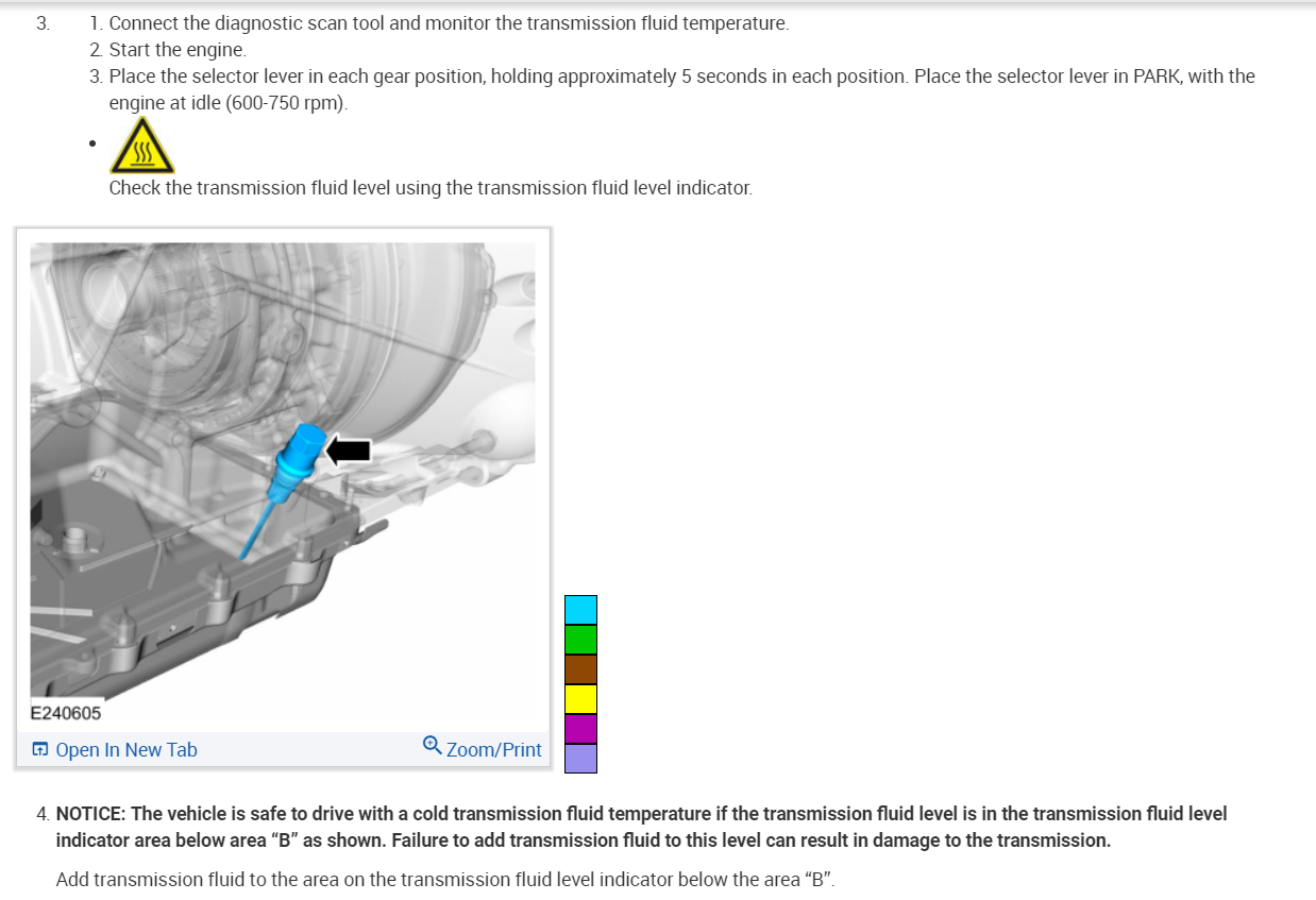

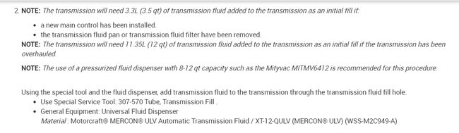

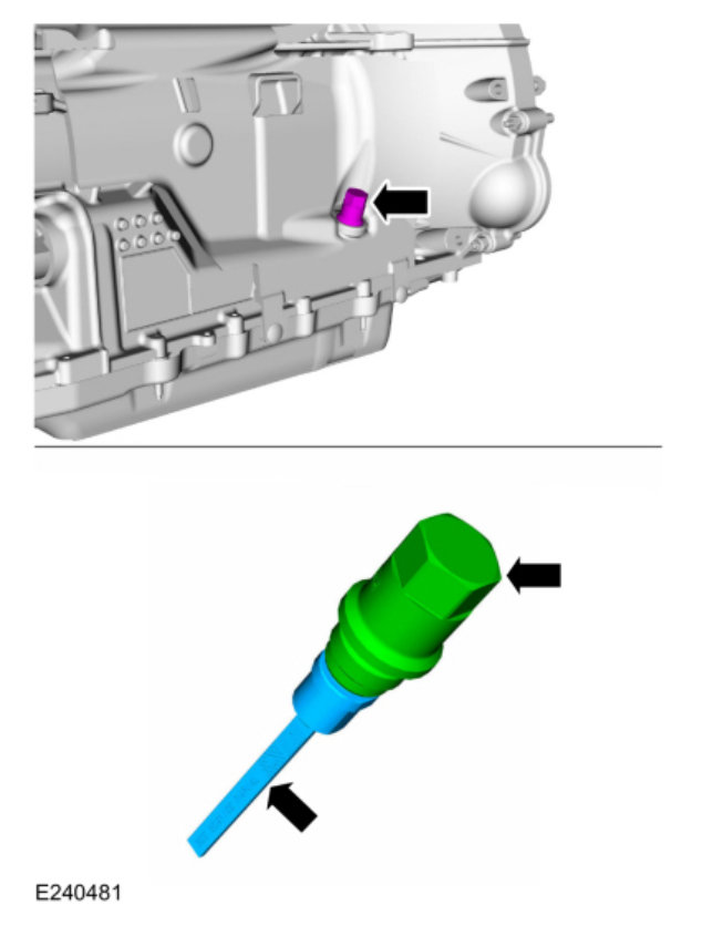

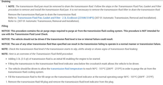

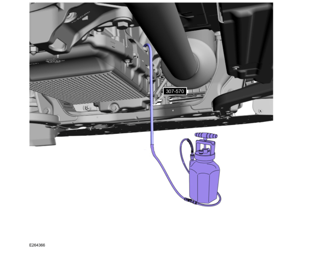

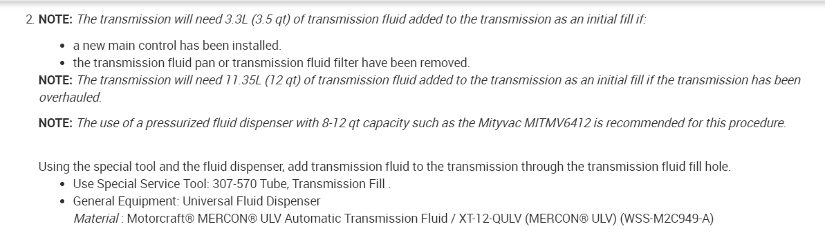

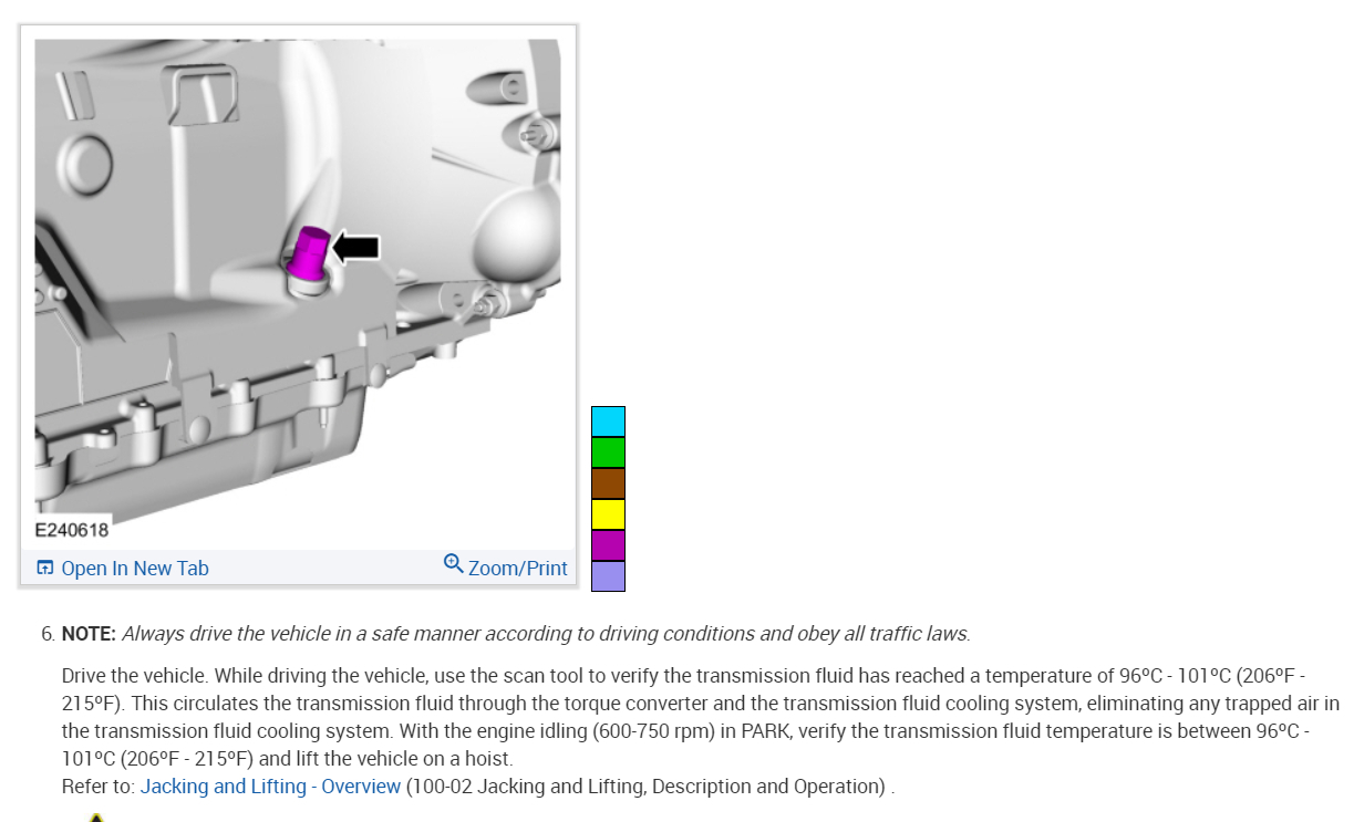

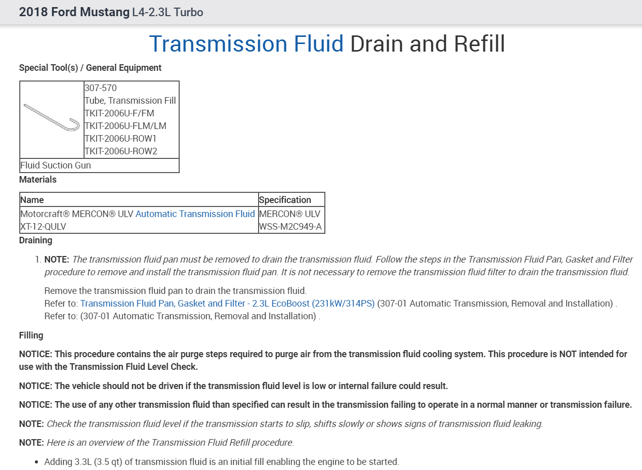

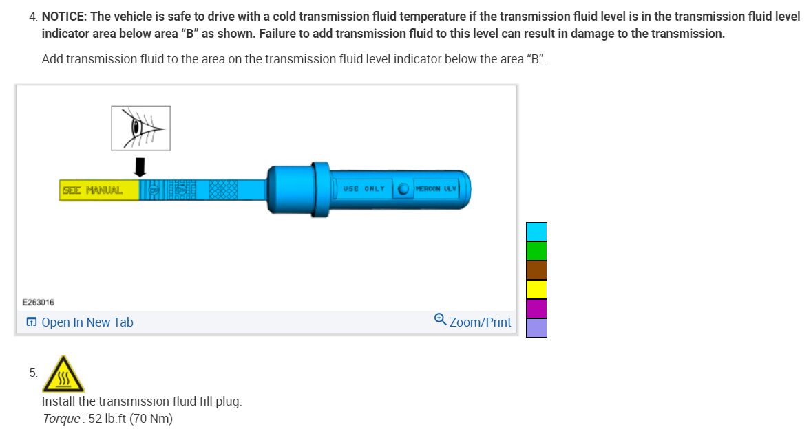

How can I change the transmission fluid in the automatic?

Here are the fluid types and capacities and how to service the transmission in the diagrams below.
Motorcraft® SAE 5W-30 Synthetic Blend Motor Oil
XO-5W30-QSP
Motorcraft® MERCON® ULV Automatic Transmission Fluid / XT-12-QULV MERCON® ULV / WSS-M2C949-A - Transmission fluid 13 qt (12.3 L)
