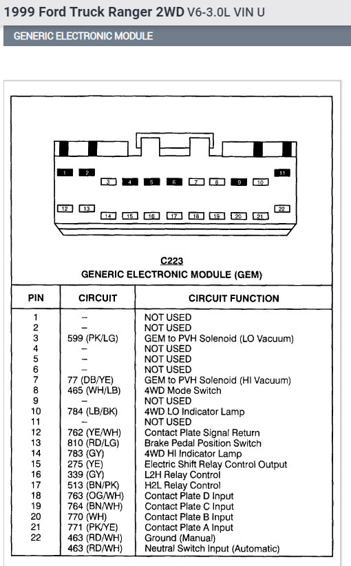

Gem Module xl5t-14b205-dc, wiring diagram needed
1999 FORD RANGER
117,000 MILES • V6 • 2WD
ERNIESEEL99
Need to snip the wire that goes to the buzzer but do not know which color wire it is.
Jun 13, 2022 at 7:12 PM
SQM
  • 6,383 POSTS

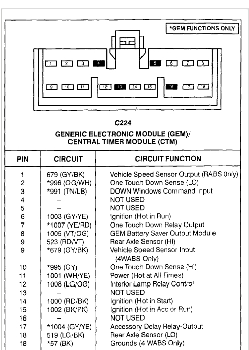

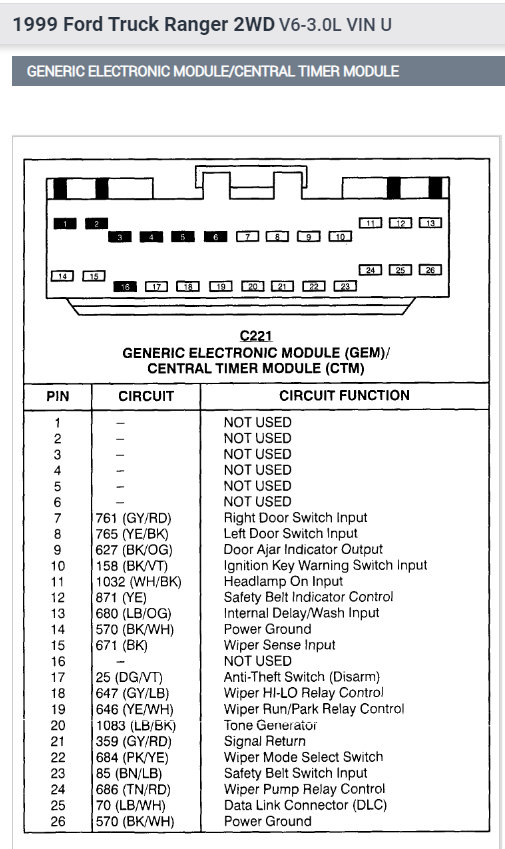

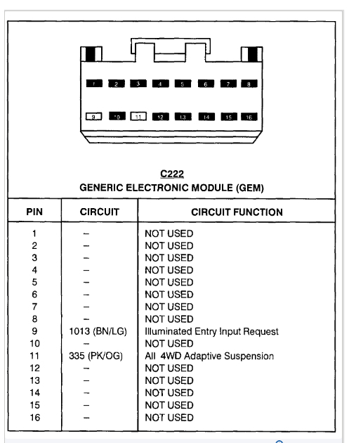

See attached for the GEM pinout, it shows the color and location of each wire.
Let me know of any questions.
