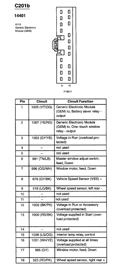

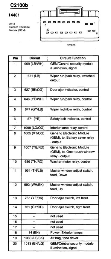

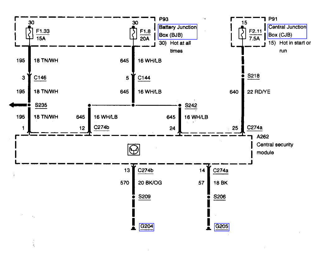

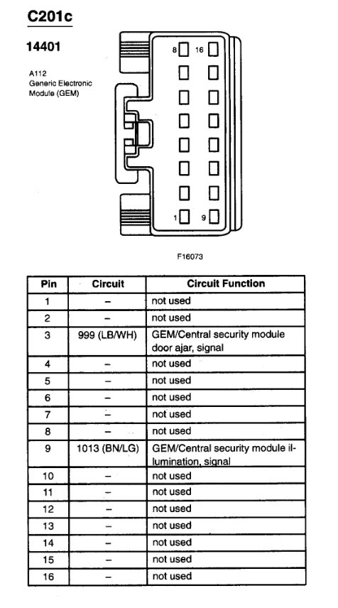

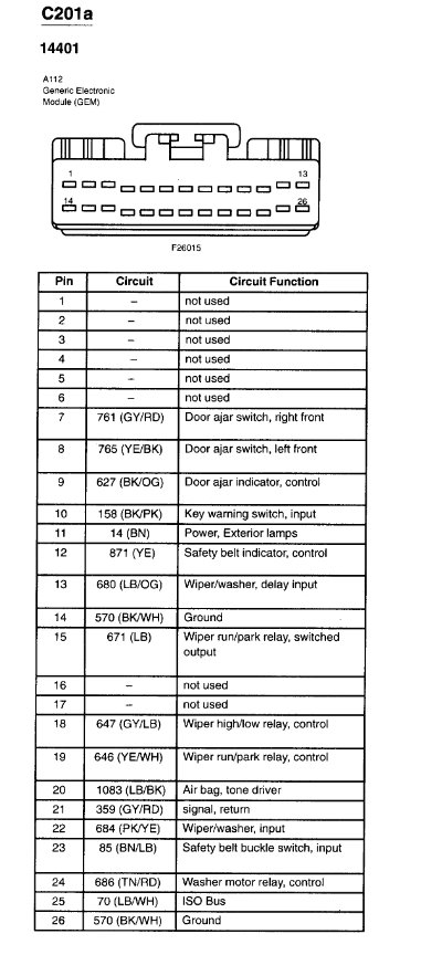

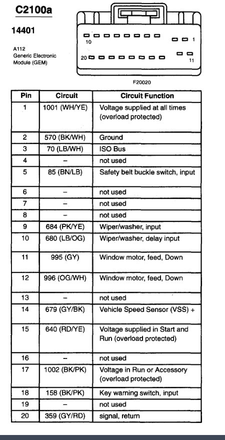

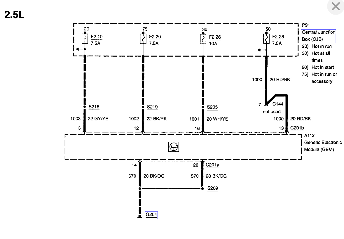

would light to find a wiring diagram for the GEM module # XL5T-14B205-DE.
Oct 31, 2021 at 12:47 AM
SQM
  • 6,383 POSTS
I have attached the wiring schematics and the pinouts for the GEM.

I would like to thank the person SQM for the answer back. It was exactly what i needed
