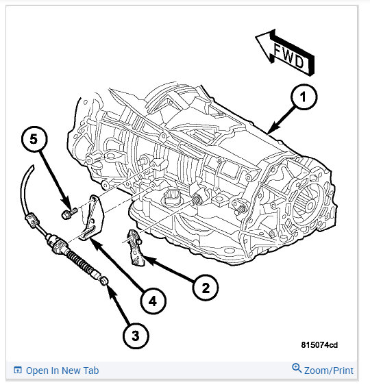

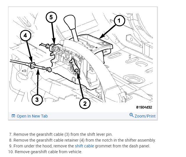

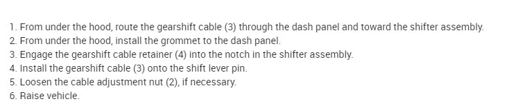

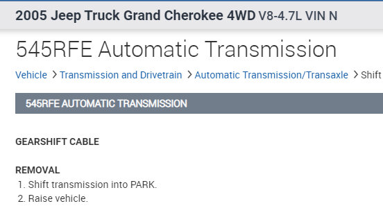

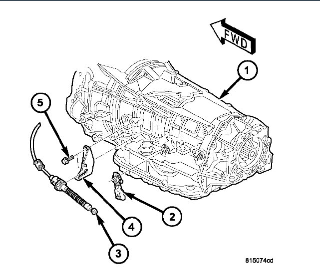

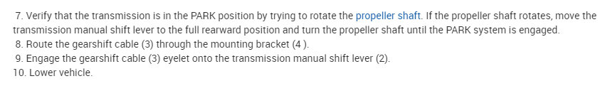

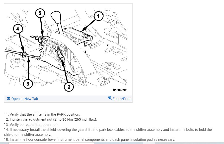

The vehicle listed above is a Laredo. The gearshift cable is broken, and I would like to know how to change it. 4.7 automatic transmission.

I'm assuming this is a 4wd vehicle. If that is incorrect, let me know.

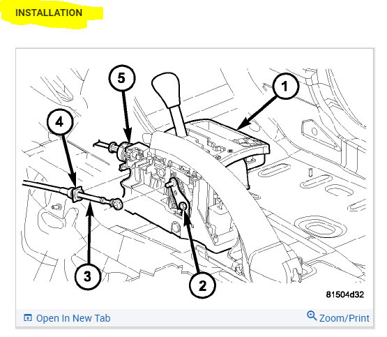

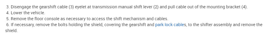

I attached the directions below for replacing the cable. As mentioned, this is for a 4wd vehicle. If that is not correct, let me know.
Let me know if this helps or if you have questions.

Thank you for the information you gave me, which was very helpful.
