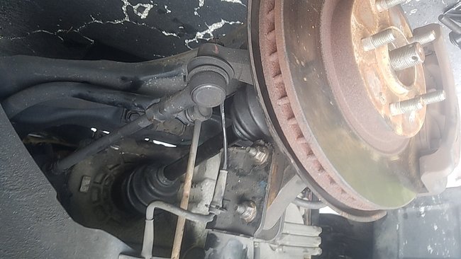

So I checked out the axle and it seems to be the issue. The driver side axle is just loose and able to be moved around. Ordered part and am going to replace it and see if that's the problem. Thank you for the help!! I will give an update after I change the part.

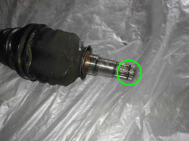

If the axle just popped out of the transaxle, then it may not have been installed correctly in the first place. There is a clip on the end of the shaft that locks it into position. You may be able to salvage that axle by resolving the clip issue. See picture.

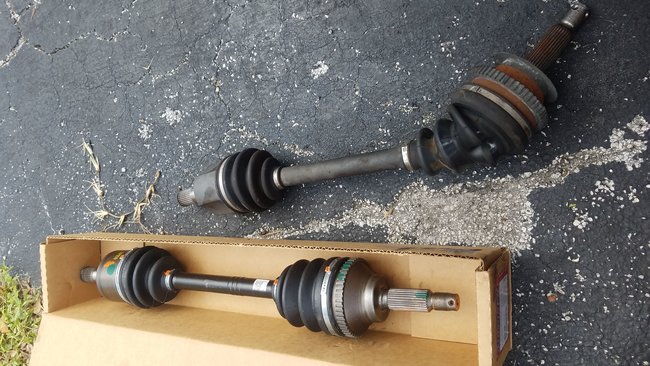

So I removed axle. It was broken inside the large bushing(don't know name) near the rotor. I replaced it and it seems to work fine. Had to order a transmission pan gasket because I removed it previously and that part comes in this afternoon. Once I put the pan and fluid on I will let you know the results. Thank you so much for the info, I believe my problem is resolved

Update. I have replaced the transmission pan with a new gasket, filled with atf, and replaced the driver side cv axle. The car is running like new. Thank you so much for your help Wrenchtech. You're advice is greatly appreciated.
