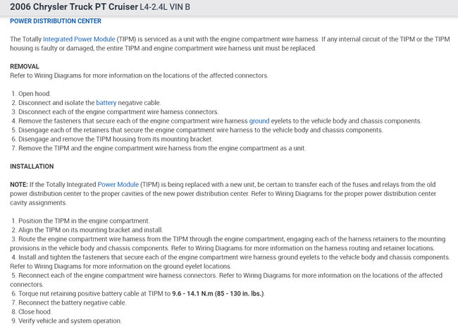

When driving the vehicle. Vehicle will not shift gears when it is needed. Having to park and turn off vehicle and turn back on. Then it will change gears when needed.
Oct 23, 2023 at 2:50 PM
  • 55,399 POSTS

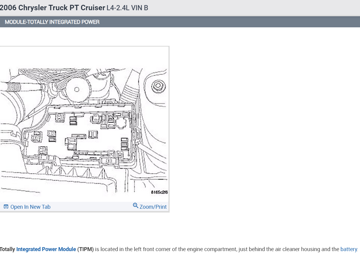

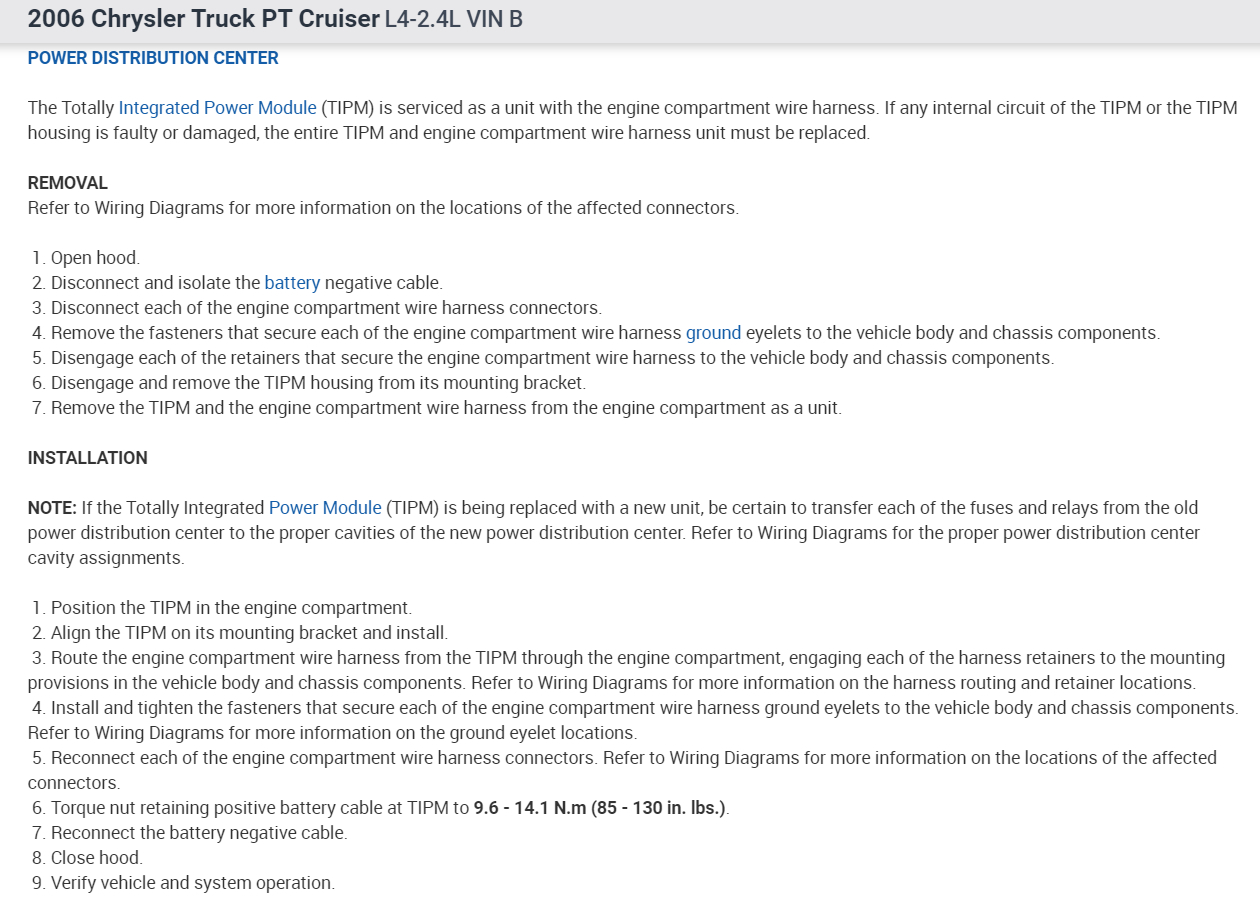

The fact that when you reset the system is telling us the TIPM or PCM is going out. You can remove the PCM and send it in to be checked but I can tell you these cars had problems with the TIPM. Here is how to change the part out, also you might want to do a CAN scan. You can get a CAN scanner (Controller Area Network) which will work on most cars from Amazon.
