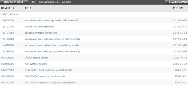

As I was getting ready to go home from work my van did not want to start. the gear would not shift. I noticed something was wrong when I backed up to park it in reverse and put it in park it did not get the gear and started going forward and it was off. I got in and moved the gear up and down to park drive and back to park what could be the problem? And is it dangerous for me to drive it like that? And is there a recall on it?

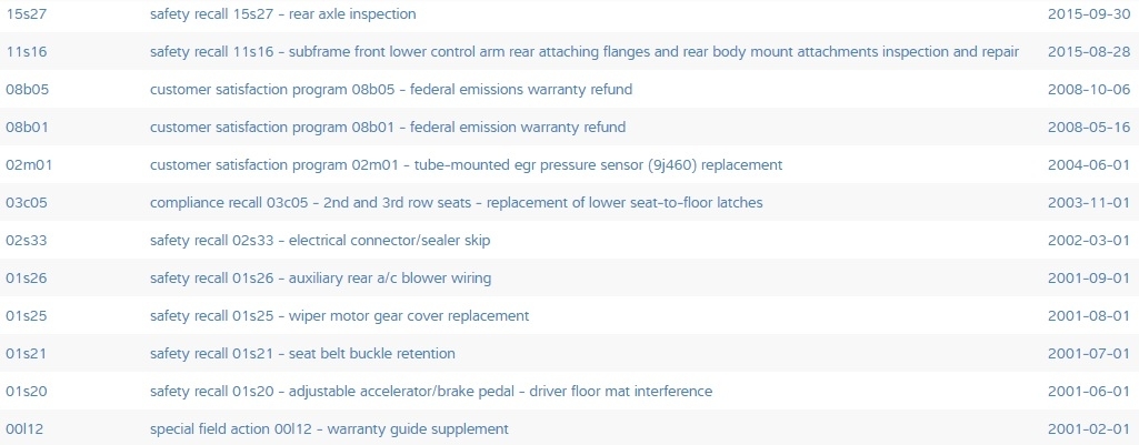

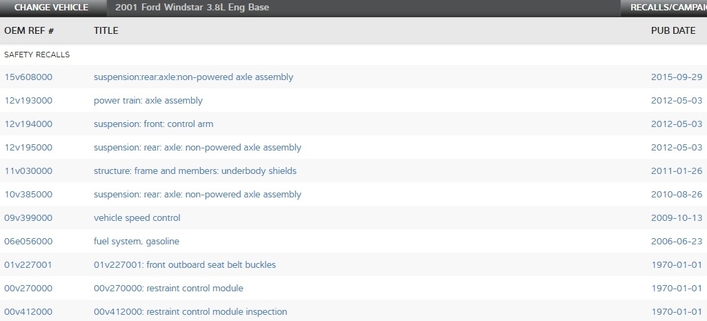

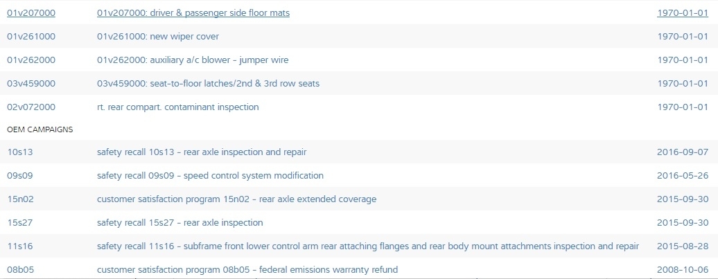

I looked up recalls in "Prodemand"
I went with the "base" model, as no other info was provided in this post. I made 3 screenshots.
Below is the list in the attached pics below.
You can also go to this site
https://www.nhtsa.gov/recalls
Enter in your VIN and pull up the recalls they show.
