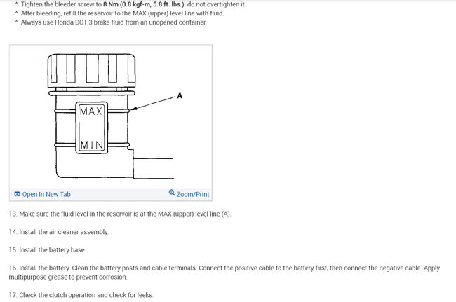

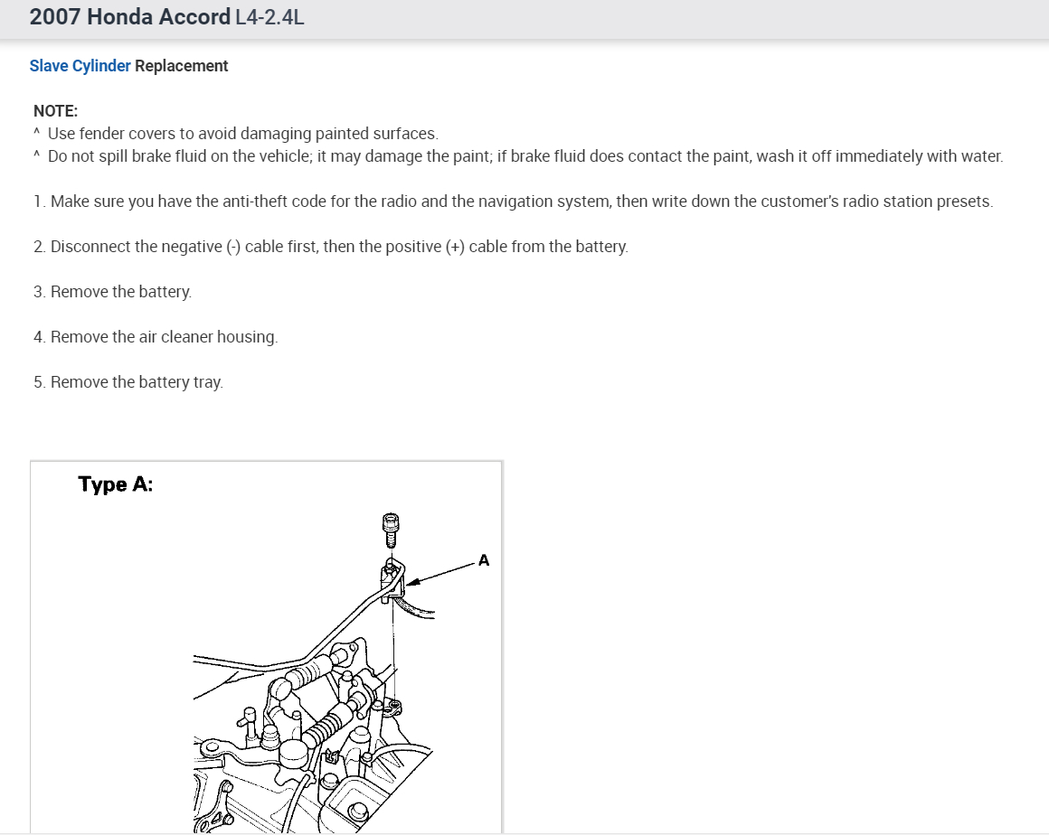

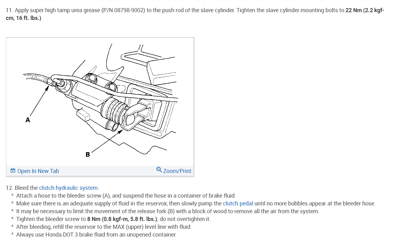

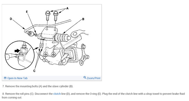

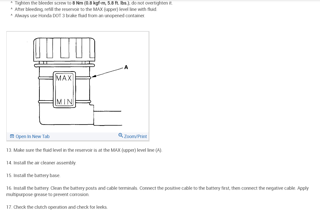

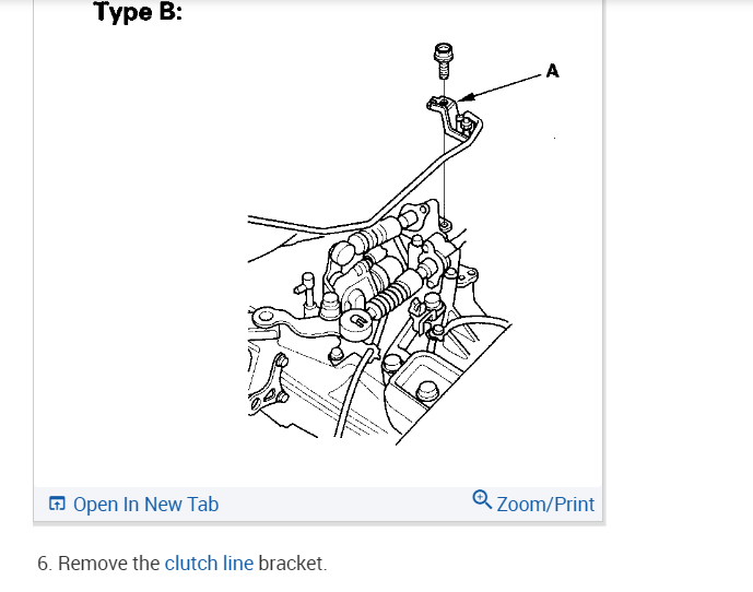

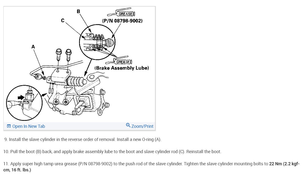

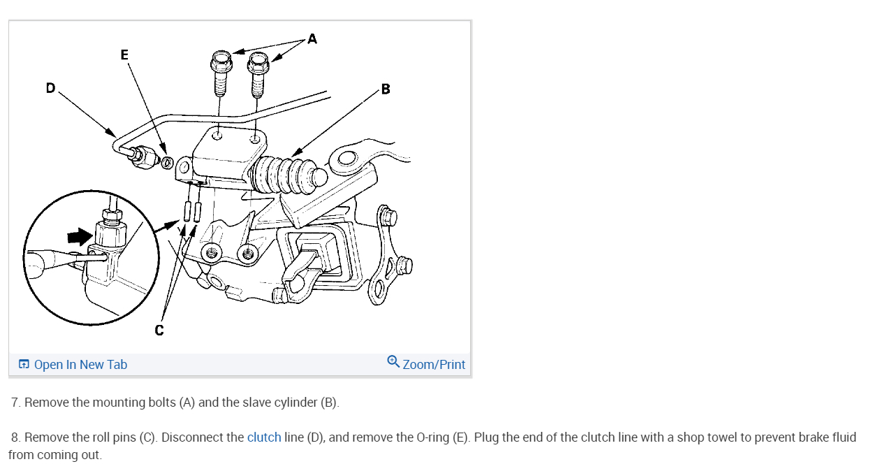

I just changed the throw out bearing and the clutch, but the car won't go in gear while it is running but will go into while not running. I bled the clutch. When you try to put it in gear, the car moves forward just a little bit but still will not go into gear.

Anytime the transmission will not go into gear the engine is running means the clutch is not working.
This guide can help you fix it. Also do you have good clutch pedal?
https://www.2carpros.com/articles/clutch-doesnt-work-sometimes-or-not-at-all
You could have a slave or master going out. here is how to bleed the system and replace the slave cylinder as well. Check out the images (below). Please let us know what you find. We are interested to see what it is.
