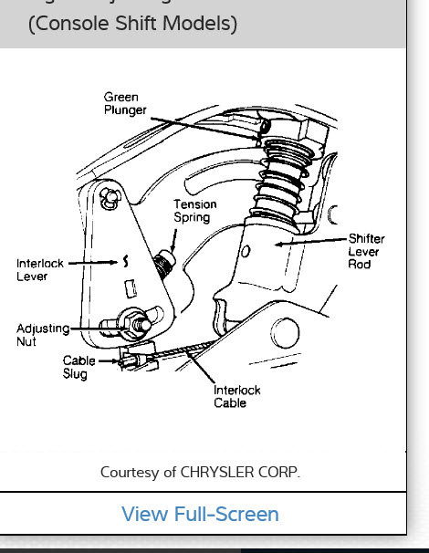

I cannot get the car to go back into park to get the key out. It will switch into other gears, but not go back into park.

have a mechanic check the adjustment or a bad cable for the shift interlock it can be either and it is in center console. Or it may be a broken part in shift mechanism.
