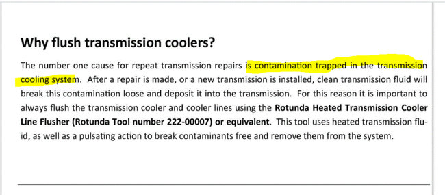

When starting to rich normal temperature the gearbox shifts into second gear and does not want to change, but all other shifting reverse, park and neutral working. when it is cold again all gears working fine first to fourth. I did change filter and put in new oil same problem need help please. i also reset ICU.

Did check the system and got no code errors. also go to gearbox center and they said it could be the valve box, but in my opinion don't think it is. then ask the radiator guys they said the oil is running to hot must install a second cooler for gearbox oil. but why was it running good for so long and the problem just start happening while driving one day?

Before running an additional cooler, has anyone tried flushing the one in the vehicle now? If it is plugged, it will still be plugged if you install an additional cooler. Therefore, it won't change anything. If it was the cooler being restricted, either replace it or flush it. An additional one shouldn't be needed.

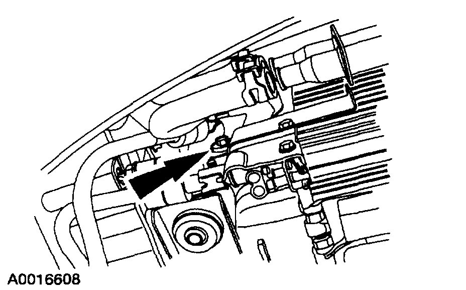

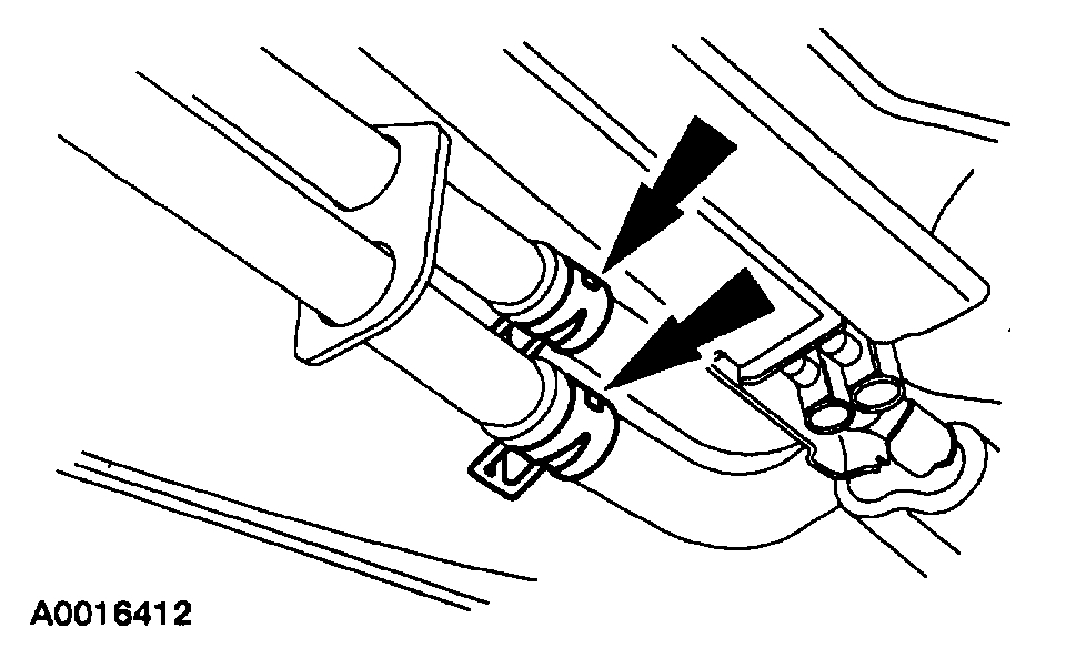

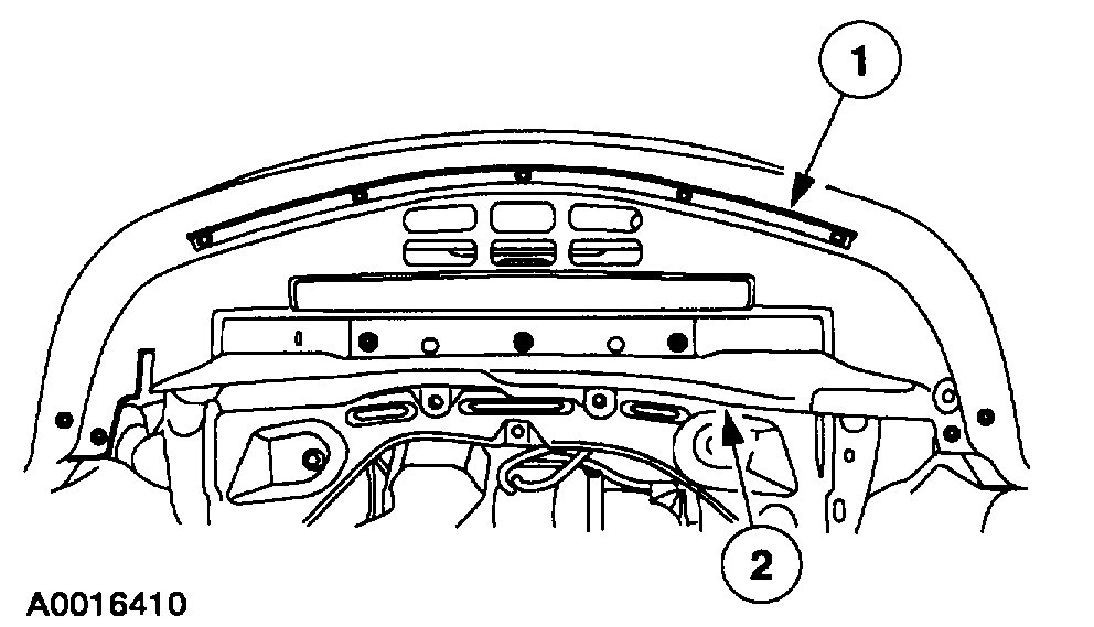

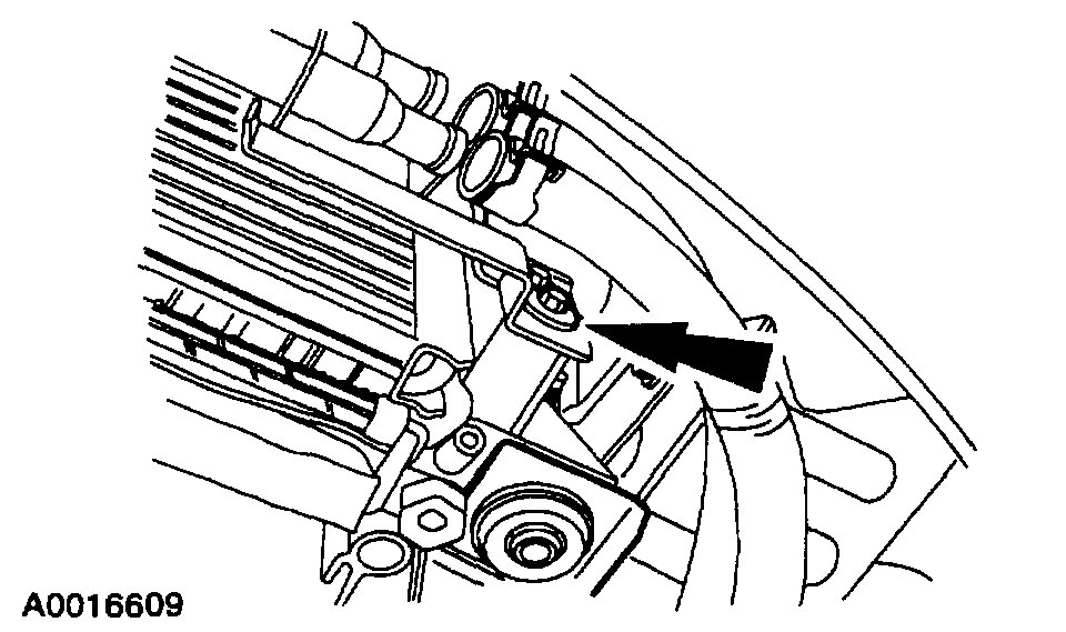

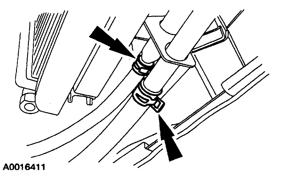

If you want to replace the cooler, here are directions for a Ford Taurus which I believe is similar to the Fairmont. The attached pics correlate with the directions.
_______________________
2000 Ford Taurus V6-3.0L VIN U
Procedures
Vehicle Transmission and Drivetrain Automatic Transmission/Transaxle Transmission Cooler Service and Repair Procedures
PROCEDURES
Removal
1. Raise and support the vehicle.
2. Remove the splash shield.
pic 1
1 Remove the five screws and air deflector, if equipped.
2 Remove the remaining seven screws and the splash shield.
3. Note: Place a drain pan under the transaxle fluid cooler.
pic 2
pic 3
Disengage the clamps and remove the transmission fluid cooler hoses and the power steering fluid cooler hoses.
pic 4
pic 5
4. Remove the bolts and the combination fluid cooler.
Installation
1. To install, reverse the removal procedure.
- Fill the transaxle to the specified level.
- Fill and purge the power steering system of air.

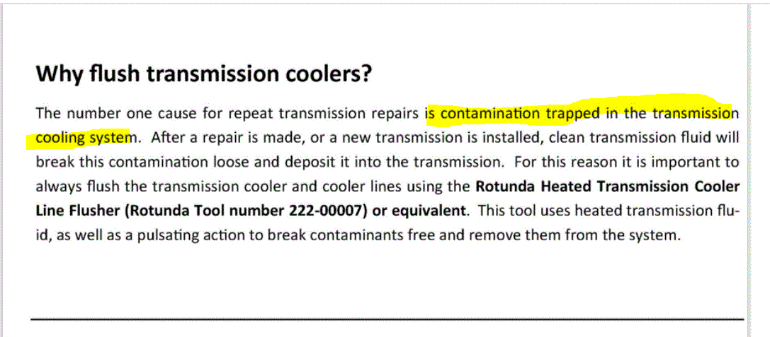

One other thing I found. There is a technical service bulletin for the Taurus. If you look at the last pic, it indicates that most transmission issues are related to a contaminated cooling system for the trans. I'm adding it because It may be a good idea to try and flush the system (specifically, the trans cooler and lines).

thanks. will clean the cooling system and give feed back.
