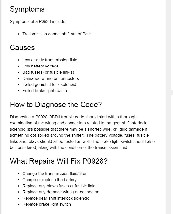

Just to add:
The error code in the transmission module is:
P092800 GEAR SHIFT SOLENOID CONTROL CIRCUIT OPEN
Below he writes:
LOT'S OF COMS FAULTS AND UNDER VOLTAGE CODES.
May 16, 2021 at 6:15 AM
This is possible that a low battery or charging system issue could be causing this.
See below for more detail on this and as you will see the low battery voltage issue will cause it.
Here are some guides that will help with this:
https://www.2carpros.com/articles/how-to-replace-a-car-battery
https://www.2carpros.com/articles/how-to-replace-an-alternator
We need to test the alternator and battery and then replace them if they fail. It sounds like they are both going to need replaced because if you are 2 volts down then that is a pretty large issue and most likely the battery will no longer be able to function and the car will stall or fail to start all together.
Please run through this material and let us know if you have other questions.
