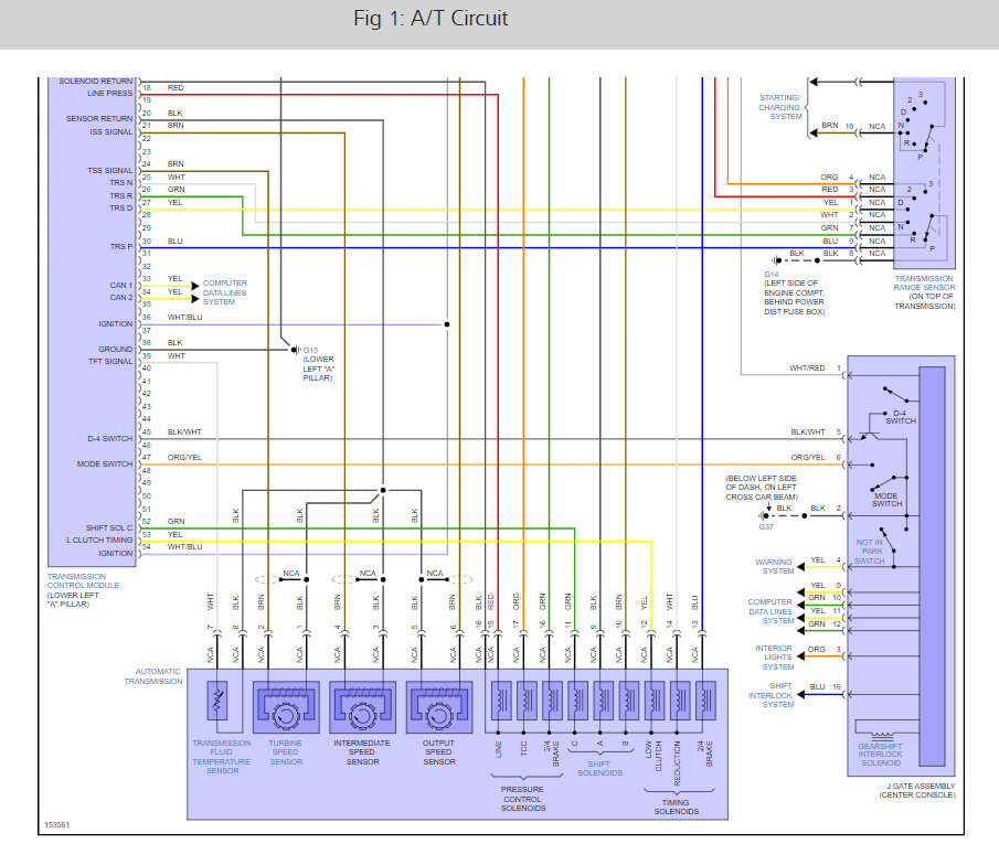

I recently got a gearbox fault on the dash, and I have an Autel scanner, so I scanned vehicle and I'm getting a p1780 code. I just changed the whole shifter out and still getting code. what could it be?
Nov 30, 2022 at 5:21 AM
  • 55,782 POSTS

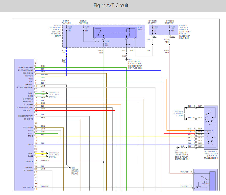

Code P1780 Transmission Control Switch (TCS) not cycled during the self-test. So, there is a g37 ground wire that needs to be checked which is at the lower left side of the dash on the car cross beam. Also, please check the fuse # f27, f5 in the under-hood fuse panel and fuse # f67 and f80 in the interior fuse panel left front of the passenger's compartment. Here is a guide to help you. Also, I have included the transmission wiring diagrams as well so you can see how the system works.
Check out the images (below). Please let us know what you find. We are interested to see what it is.
